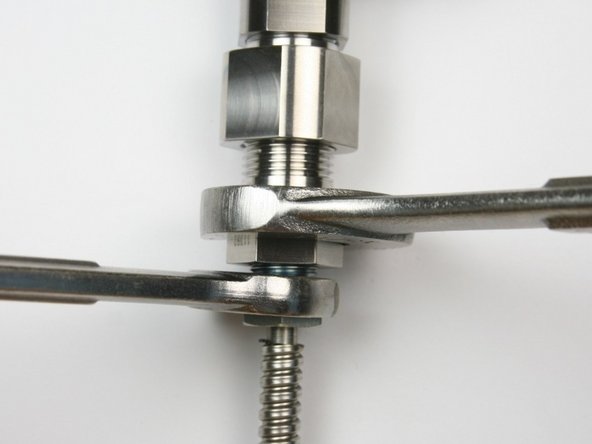

  18. Tighten back-up screw to top of bleed down valve body using a 5/16" ratchet Place flow reducer into hole beneath seat cavity in the outlet adapter Apply a layer of blue goop to external threads and seat cavity of outlet adapter
  19. Place poppet seat into seat cavity of outlet adapter Apply a layer of blue goop to top of poppet seat sitting in outlet adapter Thread outlet adapter into valve body
  20. Using a 1" wrench on outlet adapter and a 7/8" wrench on the valve body, tighten securely Apply a layer of blue goop to external threads of valve body Thread actuator housing onto valve body
  21. Tighten using a 1-1/16" wrench on actuator housing and a 7/8" wrench on valve body Thread in bleed down valve adapter to bleed down valve outlet Tighten bleed down valve adapter to bleed down valve outlet
    • Tighten bleed down valve adapter to bleed down valve outlet
  22. Apply blue goop to gland nut Thread in gland nut with HP tubing into bleed down valve adapter Tighten gland nut into bleed down valve adapter using 13/16" and 5/8" wrench
    • Apply blue goop to gland nut
    • Tighten gland nut into bleed down valve adapter using 13/16" and 5/8" wrench
  23. Apply blue goop to gland nut Thread in gland nut to side of bleed down valve body
    • Tighten gland nut to side of bleed down valve body with....
