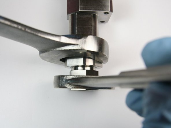

  2. Unthread hose from hydraulic fitting Loosen gland nut from side inlet of valve body Unthread gland nut from side inlet of valve body
    • Loosen gland nut from side inlet of valve body
    • Unthread gland nut from side inlet of valve body
  3. Clean gland nut of all blue goop with isopropyl alcohol loosen gland nut from outlet fitting (connected to valve body) using 13/16" and 5/8" wrench Unthread gland nut from outlet fitting (connected to valve body)
    • loosen gland nut from outlet fitting (connected to valve body) using 13/16" and 5/8" wrench
    • Unthread gland nut from outlet fitting (connected to valve body)
  4. Clean gland nut of all blue goop with isopropyl alcohol Loosen hydraulic fitting from adapter fitting using 1-1/4" and 7/8" wrench Unthread hydraulic fitting from adapter fitting
  5. Apply o-ring lubricant to o-ring from kit for hydraulic fitting Replace o-ring around hydraulic fitting with o-ring in kit (smallest o-ring in kit)
  7. Loosen actuator housing from Valve Body using 1-1/16" and 7/8" wrench Unthread actuator housing from valve body Push the Piston out of actuator housing through oil port using included dowel
    • Push the Piston out of actuator housing through oil port using included dowel
  10. Loosen 3/8" to 1/4" adapter from outlet fitting with 7/8" and 13/16" wrench Unthread 3/8" to 1/4" adapter from outlet fitting Loosen outlet fitting from bleed down valve body using 7/8" and 13/16" wrench
    • Loosen 3/8" to 1/4" adapter from outlet fitting with 7/8" and 13/16" wrench
    • Unthread 3/8" to 1/4" adapter from outlet fitting
  11. Unthread outlet fitting from bleed down valve body Remove HP Seat from bleed down valve body Remove Flow Reducer from outlet adapter
    • Remove HP Seat from bleed down valve body
  12. Clean outlet adapter of all blue goop with isopropyl alcohol Discard seat Loosen back-up screw from top of bleed down valve body using a 5/16" ratchet
    • Discard seat
    • Loosen back-up screw from top of bleed down valve body using a 5/16" ratchet
  13. Unthread seal back-up screw from top of bleed down valve body Clean seal back-up screw with isopropyl alcohol Push components through bleed down valve body with included dowel
  14. Clean bleed down valve body with isopropyl alcohol Apply high vacuum grease to Needle Slide back-up screw on to needle to flat end of needle is flush with non threaded part of back-up screw
  15. Slide bushing onto point of needle with chamfered end towards back-up screw Place hoop with tapered end onto non o-ring side of HP Seal Place HP seal assembly onto point of needle with hoop first
  16. Apply high vacuum grease to exterior of HP seal, hoop, and bushing Apply high vacuum grease to internal threads of bleed down valve body Insert high pressure needle assembly into top of bleed down valve body with point first
  17. Push seal backup screw inside of valve body until it bottoms out Take seal backup screw out of body and apply a layer of blue goop to threads Thread in back-up screw into top of bleed down valve body
  18. Tighten back-up screw to top of bleed down valve body using a 5/16" ratchet Place flow reducer into hole beneath seat cavity in the outlet adapter Apply a layer of blue goop to external threads and seat cavity of outlet adapter
  19. Place poppet seat into seat cavity of outlet adapter Apply a layer of blue goop to top of poppet seat sitting in outlet adapter Thread outlet adapter into valve body
  20. Using a 1" wrench on outlet adapter and a 7/8" wrench on the valve body, tighten securely Apply a layer of blue goop to external threads of valve body Thread actuator housing onto valve body
  21. Tighten using a 1-1/16" wrench on actuator housing and a 7/8" wrench on valve body Thread in bleed down valve adapter to bleed down valve outlet Tighten bleed down valve adapter to bleed down valve outlet
    • Tighten bleed down valve adapter to bleed down valve outlet
  22. Apply blue goop to gland nut Thread in gland nut with HP tubing into bleed down valve adapter
    • Apply blue goop to gland nut
    • Tighten gland nut into bleed down valve adapter using......
  23. Apply blue goop to gland nut Thread in gland nut to side of bleed down valve body
    • Tighten gland nut to side of bleed down valve body with....
  24. Thread in adapter fitting into actuator housing Tighten adapter fitting into actuator housing
    • Thread in adapter fitting into actuator housing
    • Tighten adapter fitting into actuator housing
    • Thread in hydraulic adapter into adapter fitting
    • Tighten hydraulic fitting into adapter fitting
