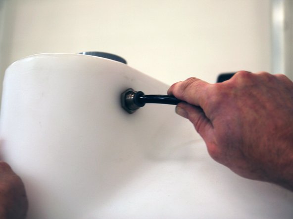

  2. Connect the “permeate” line to the bulkhead fitting in the water storage tank. Connect the “permeate” line to the bulkhead fitting in the water storage tank.
    • Connect the “permeate” line to the bulkhead fitting in the water storage tank.

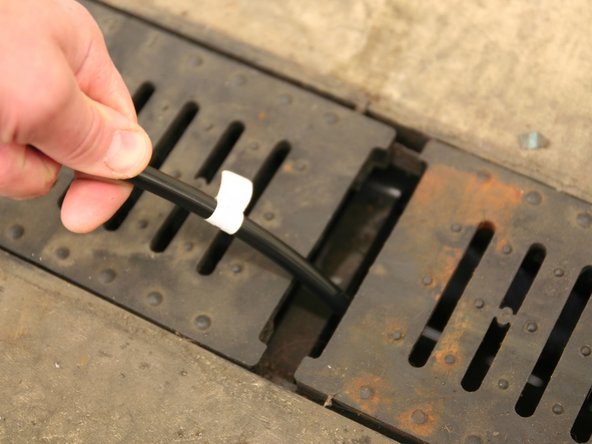

  3. Route the “concentrate” line to a drain. Route the “concentrate” line to a drain.
    • Route the “concentrate” line to a drain.

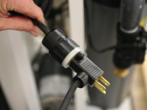

  6. Plug the cord for the RO system into the back side of the float gauge plug.
    • Plug the cord for the RO system into the back side of the float gauge plug.

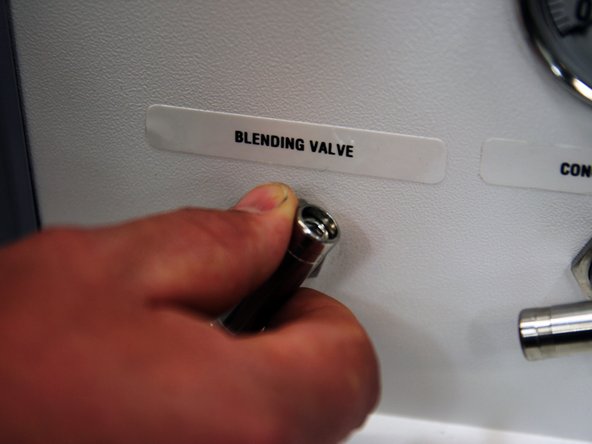

    • Fully close the blending valve (clockwise).

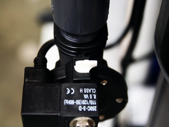

  8. Offset the position of the white lever on the solenoid valve (incoming water). Turn the feed water on and let the system purge until no visible bubbles appear from concentrate flow meter.
    • Offset the position of the white lever on the solenoid valve (incoming water).
    • Turn the feed water on and let the system purge until no visible bubbles appear from concentrate flow meter.

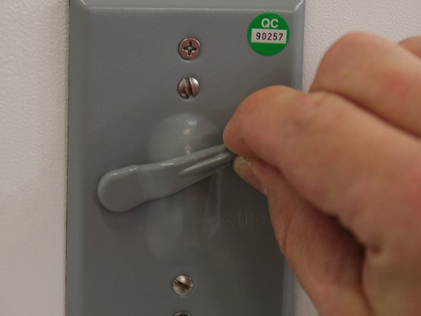

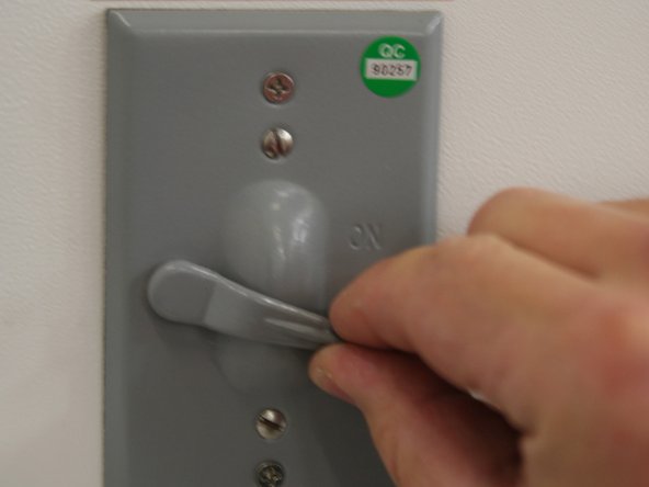

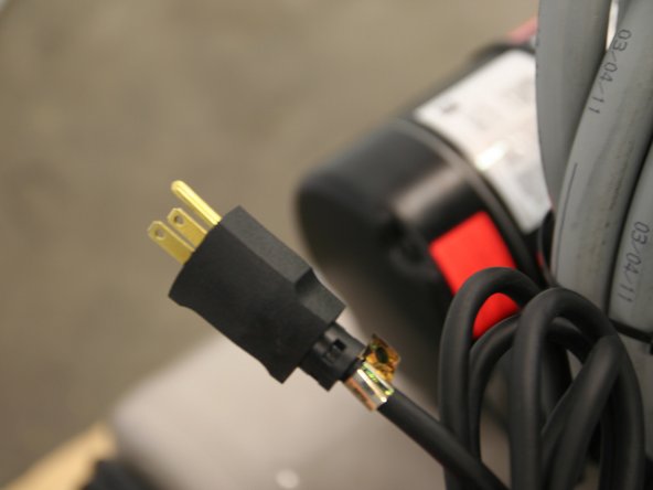

  10. Return position of the white lever (inline) on the solenoid valve. Plug in the RO unit, float gauge plug into a dedicated 15 amp circuit.  Plug the boost pump plug into a separate 15-amp circuit.
    • Return position of the white lever (inline) on the solenoid valve.
    • Plug in the RO unit, float gauge plug into a dedicated 15 amp circuit. Plug the boost pump plug into a separate 15-amp circuit.

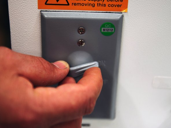

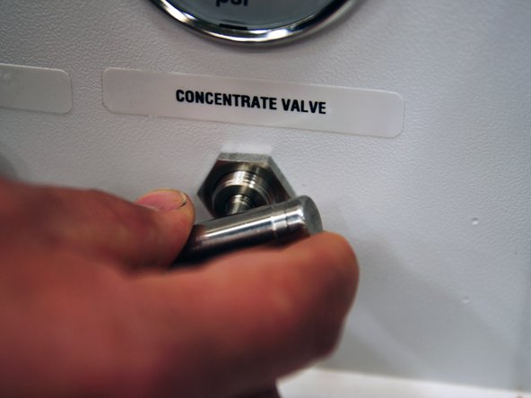

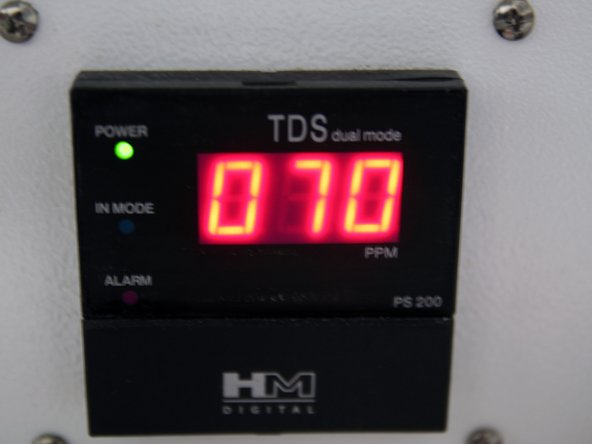

  11. Turn the RO System on. Adjust the concentrate valve and blending valve on the pump to the designed flow, TDS (70-80 ppm), and pressure.
    • Turn the RO System on.
    • Adjust the concentrate valve and blending valve on the pump to the designed flow, TDS (70-80 ppm), and pressure.

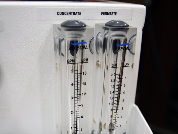

  13. Record readings daily for a week and after a week record readings once a week.
    • Record readings daily for a week and after a week record readings once a week.
    • Adjust the pump bypass valve (show picture of bypass valve and pressure) and concentrate valve until the correct flow is achieved. For example AS-ROS 2000 should be adjusted until it produces about 2000 GPD or 1.38 GPM of permeate (product water) at 77°F. GPM = GPD/1440 Example: 1.38 = 2000/1440
