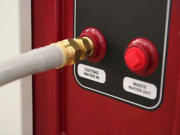

  1. Connect the incoming water. Available connections include a female garden hose fitting, 3/4” NPT, and 1” NPT.
    • Connect the incoming water. Available connections include a female garden hose fitting, 3/4” NPT, and 1” NPT.
    • Verify water supply complies with minimum system requirements.

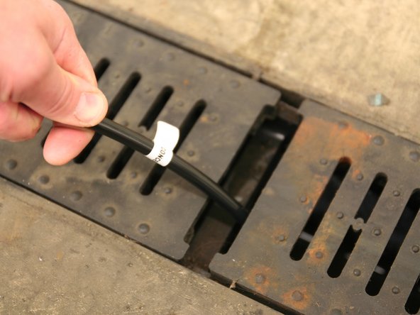

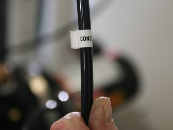

  3. Route the “concentrate” line to a drain. Route the “concentrate” line to a drain.
    • Route the “concentrate” line to a drain.

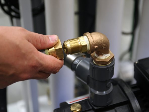

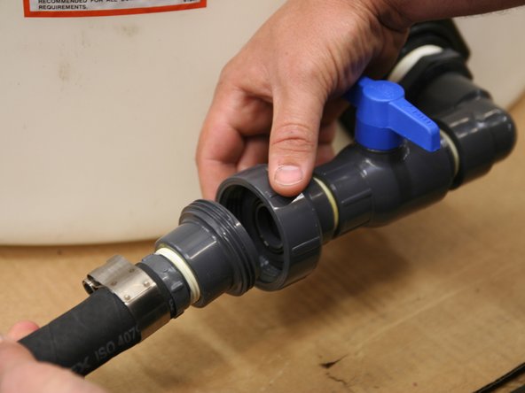

  4. Connect the union fitting from the boost pump to the atmospheric tank. Attach the grey hose to the boost pump. Attach the other end of the supply hose to your intensier pump.
    • Connect the union fitting from the boost pump to the atmospheric tank.
    • Attach the grey hose to the boost pump.
    • Attach the other end of the supply hose to your intensier pump.

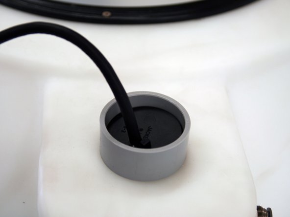

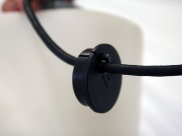

  5. Drop the float gauge into the tank and bring the plug end through the grey opening at the top. Attach the rubber stopper to the cord and reinsert into the grey opening. Make sure to adjust the cord to be 10” from top of tank to metal bullet. Drop the float gauge into the tank and bring the plug end through the grey opening at the top. Attach the rubber stopper to the cord and reinsert into the grey opening. Make sure to adjust the cord to be 10” from top of tank to metal bullet. Drop the float gauge into the tank and bring the plug end through the grey opening at the top. Attach the rubber stopper to the cord and reinsert into the grey opening. Make sure to adjust the cord to be 10” from top of tank to metal bullet.
    • Drop the float gauge into the tank and bring the plug end through the grey opening at the top. Attach the rubber stopper to the cord and reinsert into the grey opening. Make sure to adjust the cord to be 10” from top of tank to metal bullet.
