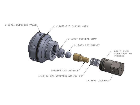

  2. Exploded view with BOM Exploded view with BOM
    • Exploded view with BOM

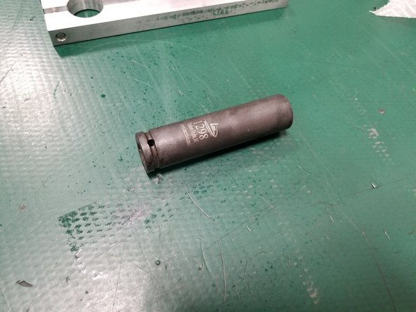

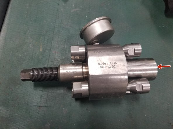

  3. Pressure Loading tool Check valve clamp tool Plunger removal socket
    • Pressure Loading tool
    • Check valve clamp tool
    • Plunger removal socket

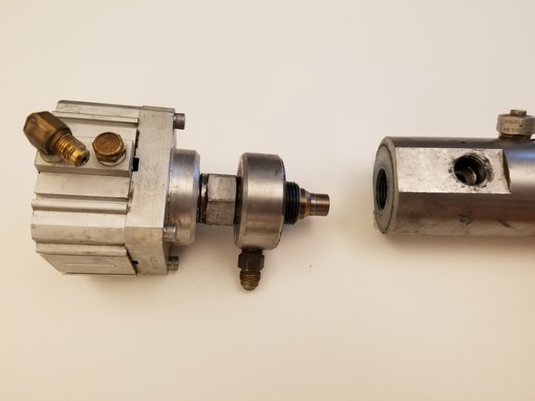

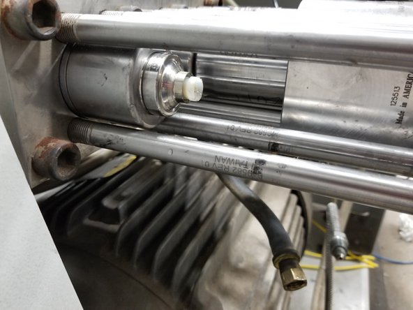

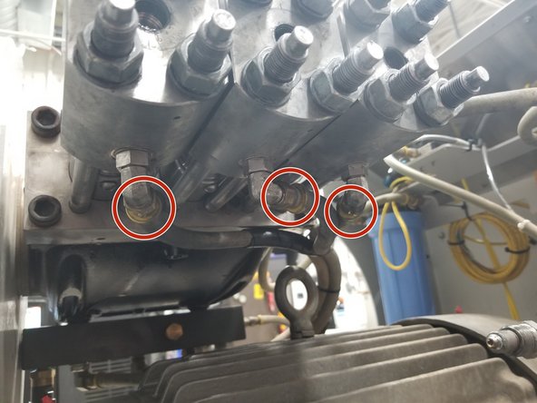

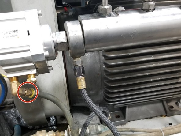

  4. Remove inlet water hoses from the bottom of the end cap Disconnect air line from actuator Disconnect PCV drain line
    • Remove inlet water hoses from the bottom of the end cap
    • Disconnect air line from actuator
    • Disconnect PCV drain line

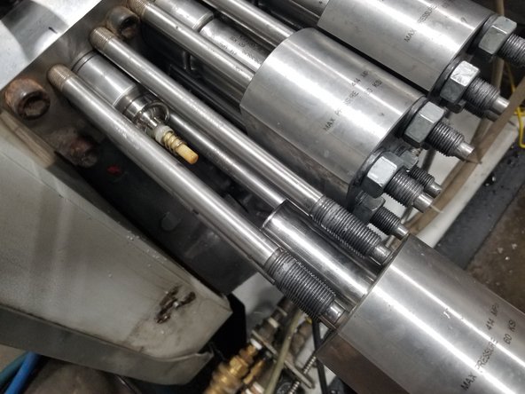

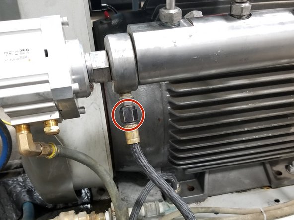

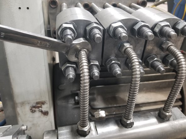

  5. Remove high-pressure tube from manifold using a 13/16" open end wrench Remove high-pressure inlets from all end caps using 13/16" open end wrench while supporting the manifold
    • Remove high-pressure tube from manifold using a 13/16" open end wrench
    • Remove high-pressure inlets from all end caps using 13/16" open end wrench while supporting the manifold
  6. Ensure oil is full. Open the 3/16" hex screw located on the contact face to check/fill using ATF fluid Ensure pressure loading tool screw is fully retracted
    • Ensure oil is full. Open the 3/16" hex screw located on the contact face to check/fill using ATF fluid
    • Ensure pressure loading tool screw is fully retracted
    • Ensure piston is fully retracted

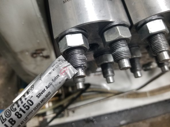

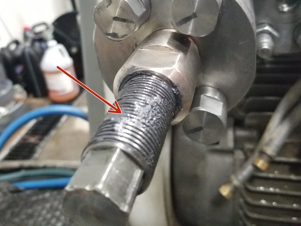

  7. Keep screw lubricated with MOLYKOTE® BR-2 Plus or similar Wipe stud threads clean and apply Loctite 8150 anti-seize (#1-18750)
    • Keep screw lubricated with MOLYKOTE® BR-2 Plus or similar
    • Wipe stud threads clean and apply Loctite 8150 anti-seize (#1-18750)

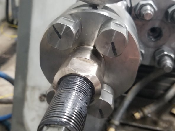

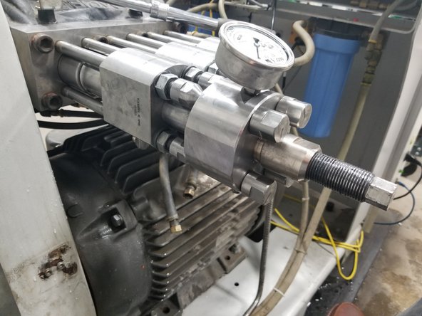

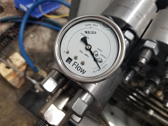

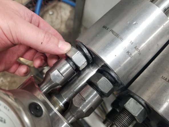

  8. Attach pressure loading tool to each set of studs, rotating each tool stud by hand until tight Once snug, back out the tool studs 1/4 turn. Place a radial line with a permanent marker to make this easier to see Use a 3/4" (19mm) ratcheting socket to pressurize the tool by rotating screw clockwise. Pressurize per manufacturers recommended gauge pressure
    • Attach pressure loading tool to each set of studs, rotating each tool stud by hand until tight
    • Once snug, back out the tool studs 1/4 turn. Place a radial line with a permanent marker to make this easier to see
    • Use a 3/4" (19mm) ratcheting socket to pressurize the tool by rotating screw clockwise. Pressurize per manufacturers recommended gauge pressure

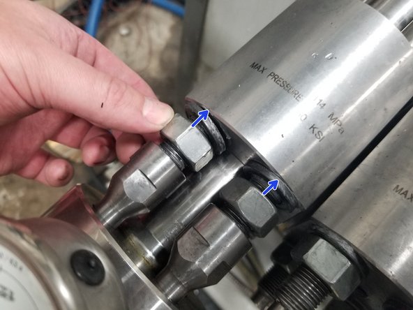

  9. While tool is pressurized, loosen the four nuts a few turns by hand
    • While tool is pressurized, loosen the four nuts a few turns by hand
    • Turn the 3/4" socket counter-clockwise to reduce the pressure in the tool
    • Back off each of the four tool studs and remove the pressure loading tool

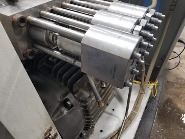

  10. Remove the fours nuts and washers Carefully slide the end cap off, being careful not to lose any of the high-pressure components
    • Remove the fours nuts and washers
    • Carefully slide the end cap off, being careful not to lose any of the high-pressure components

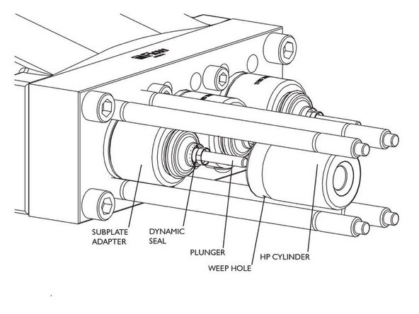

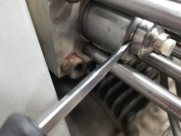

  11. HP cylinder and filler tube may come out with end cap Use a screwdriver to remove seal carrier, if necessary
    • HP cylinder and filler tube may come out with end cap
    • Use a screwdriver to remove seal carrier, if necessary

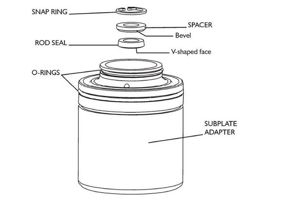

  12. Remove subplate adapter (gently pry groove if necessary) Remove snap ring and rod seal, install new rod seal (1-11993) and snap ring (1-18745). Inspect and replace spacer with bevel down
    • Remove subplate adapter (gently pry groove if necessary)
    • Remove snap ring and rod seal, install new rod seal (1-11993) and snap ring (1-18745). Inspect and replace spacer with bevel down

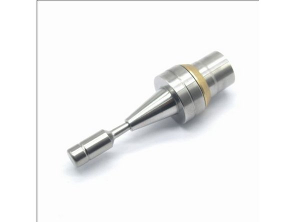

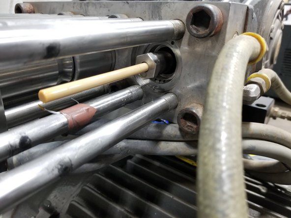

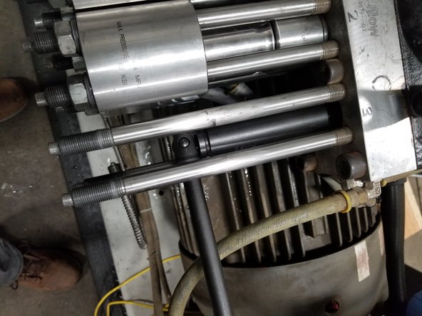

  13. Use plunger removal socket and ratchet to remove the plunger retaining nut Rotate belt/crank to extend plunger, if necessary Replace with new plunger and spring. Torque plunger nut to 20 ft-lb (27 N-m).Be careful not to contact the plunger
    • Use plunger removal socket and ratchet to remove the plunger retaining nut
    • Rotate belt/crank to extend plunger, if necessary
    • Replace with new plunger and spring. Torque plunger nut to 20 ft-lb (27 N-m).Be careful not to contact the plunger

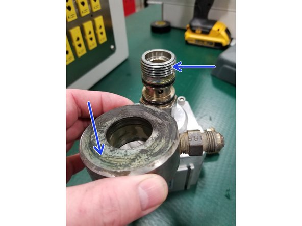

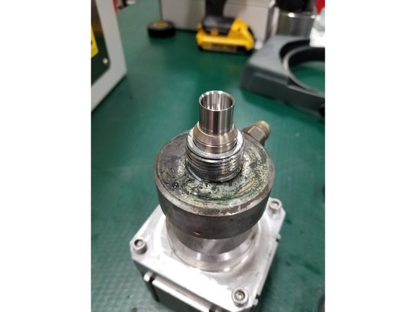

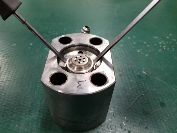

  14. Carefully lift the check valve assembly using two flathead screwdrivers in the groove on the check valve body
    • Carefully lift the check valve assembly using two flathead screwdrivers in the groove on the check valve body

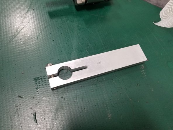

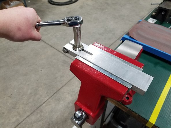

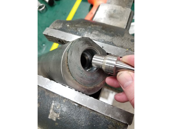

  15. Insert check valve body clamp tool into bench vise Use a 9/16" socket to tighten the clamp onto the check valve body Remove the Outlet Cage using the 9/16" socket
    • Insert check valve body clamp tool into bench vise
    • Use a 9/16" socket to tighten the clamp onto the check valve body
    • Remove the Outlet Cage using the 9/16" socket
    • Inspect outlet cage. Replace all other items
    • Re-install outlet cage:
    • Apply blue lubricant to outlet cage threads and insert new internal components
    • Carefully thread cage into check valve while maintaining alignment of internal components
    • Torque outlet cage to 30 ft-lb (41 N-m)

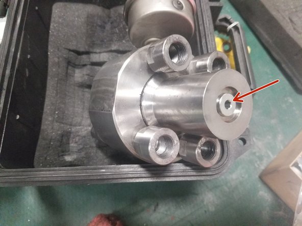

  16. Install new End Cap o-ring
    • Install new End Cap o-ring
    • Apply high-vac grease (1-11447) to both o-rings
    • Insert check valve assembly into end cap

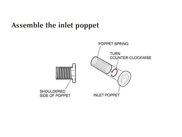

  19. Attach 1-18747 spring to 1-18865 Inlet Poppet
    • Attach 1-18747 spring to 1-18865 Inlet Poppet

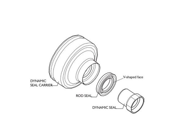

  20. Insert dynamic seal and rod seal into new seal carrier (slight pressure is required to seat dynamic seal) Install rebuilt subplate adapter
    • Insert dynamic seal and rod seal into new seal carrier (slight pressure is required to seat dynamic seal)
    • Install rebuilt subplate adapter
    • Slide seal assembly over plunger up to subplate adapter

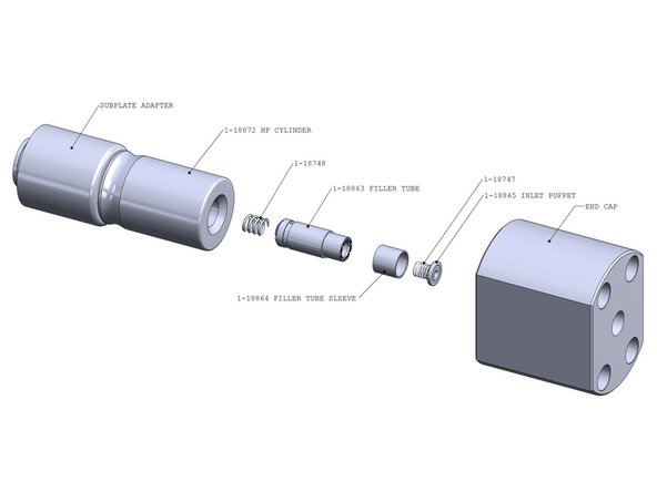

  21. Insert new o-ring into HP Cylinder. Apply a small amount of high-vac grease to o-ring Carefully slide HP cylinder over the seal carrier, keeping the weep hole facing down Insert 1-18748 spring into Filler Tube. Slide filler tube sleeve onto filler tube, insert poppet assembly into filler tube
    • Insert new o-ring into HP Cylinder. Apply a small amount of high-vac grease to o-ring
    • Carefully slide HP cylinder over the seal carrier, keeping the weep hole facing down
    • Insert 1-18748 spring into Filler Tube. Slide filler tube sleeve onto filler tube, insert poppet assembly into filler tube
    • Insert assembly into HP Cylinder
  22. Slide End Cap onto tie rods and align with HP Cylinder
    • Slide End Cap onto tie rods and align with HP Cylinder
    • Place washers and nuts on tie rods, hand tighten until snug
    • Attach and pressurize the pressure loading tool. Tighten nuts by hand until they are snug against the end cap
    • Remove pressure from pressure loading tool
    • Repeat for all three lines
