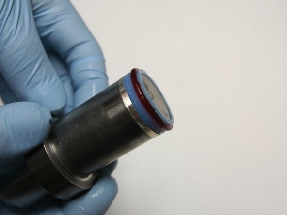

  1. Use the small stepped end of the installation tool to push the internal back-up sleeve through the cylinder forcing the seal and hoop out of the other end of the high-pressure cylinder. Turn over the high-pressure cylinder and repeat this process. Thoroughly clean the high-pressure cylinder with isopropyl alcohol or a similar cleaning agent.
    • Use the small stepped end of the installation tool to push the internal back-up sleeve through the cylinder forcing the seal and hoop out of the other end of the high-pressure cylinder.
    • Turn over the high-pressure cylinder and repeat this process.
    • Thoroughly clean the high-pressure cylinder with isopropyl alcohol or a similar cleaning agent.

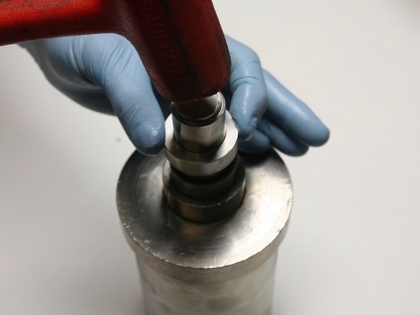

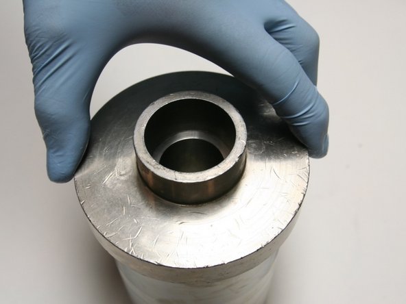

  2. Visually inspect the bore of the high-pressure cylinder and check for cracks/blemishes. Roll Scotch Brite on both ends of the high-pressure cylinder to smooth out blemishes. Put the sleeve guide tool onto one end of the high-pressure cylinder.
    • Visually inspect the bore of the high-pressure cylinder and check for cracks/blemishes.
    • Roll Scotch Brite on both ends of the high-pressure cylinder to smooth out blemishes.
    • Put the sleeve guide tool onto one end of the high-pressure cylinder.
    • The sleeve guide should spin on the high-pressure cylinder when installed correctly.

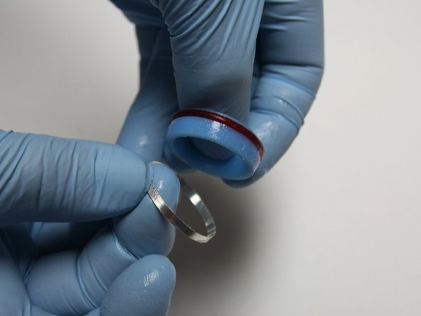

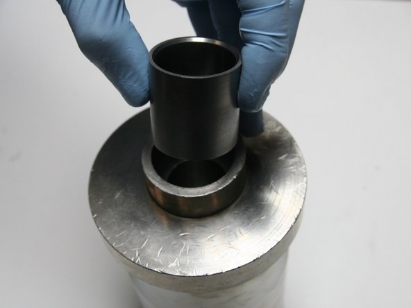

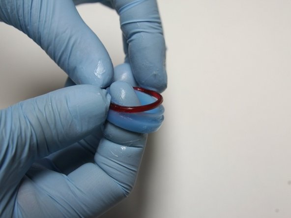

  3. Put the installation sleeve into the sleeve guide with the larger ID, tapered end, up. Apply high vacuum grease to the O-ring. Put the O-ring on the seal.
    • Put the installation sleeve into the sleeve guide with the larger ID, tapered end, up.
    • Apply high vacuum grease to the O-ring.
    • Put the O-ring on the seal.

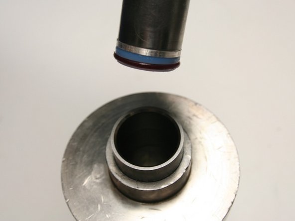

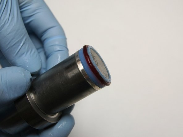

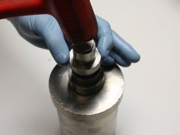

  4. Put the hoop onto the seal with the sharp (tapered) end towards the seal. Put the seal and hoop onto the bigger stepped side of the installation tool. Put the installation tool, with the hoop and seal, into the sleeve.
    • Put the hoop onto the seal with the sharp (tapered) end towards the seal.
    • Put the seal and hoop onto the bigger stepped side of the installation tool.
    • Put the installation tool, with the hoop and seal, into the sleeve.

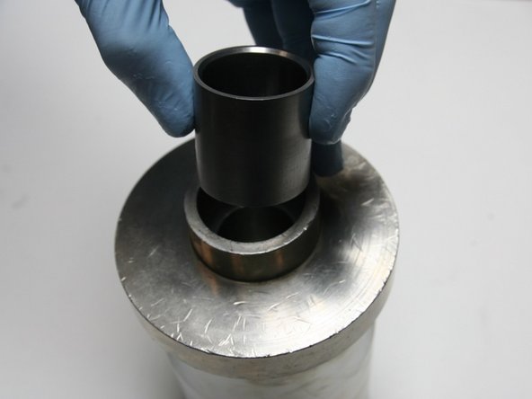

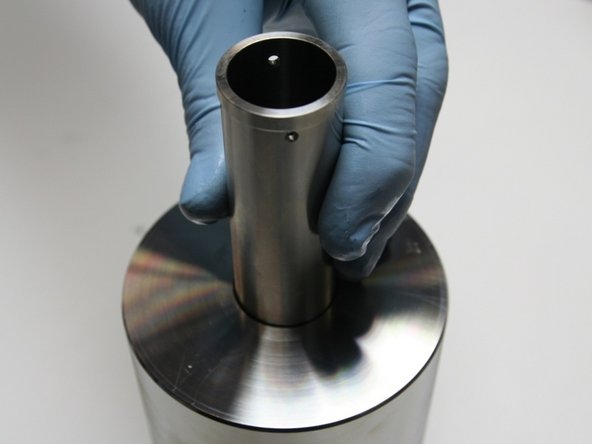

  5. Secure the hoop in place by tapping the installation tool with a rubber mallet until the tool bottoms out on the guide. Apply high vacuum grease to both ends of the spacer tube. Remove the tools from the finished end of the high-pressure cylinder, turn the high-pressure cylinder over, and insert the spacer tube into the bore.
    • Secure the hoop in place by tapping the installation tool with a rubber mallet until the tool bottoms out on the guide.
    • Apply high vacuum grease to both ends of the spacer tube.
    • Remove the tools from the finished end of the high-pressure cylinder, turn the high-pressure cylinder over, and insert the spacer tube into the bore.

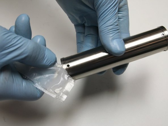

  6. Put the sleeve guide tool onto the end of the high-pressure cylinder. The sleeve guide should spin on the high-pressure cylinder when installed correctly. Put the installation sleeve into the sleeve guide with the larger ID, with the tapered end, up.
    • Put the sleeve guide tool onto the end of the high-pressure cylinder.
    • Put the installation sleeve into the sleeve guide with the larger ID, with the tapered end, up.

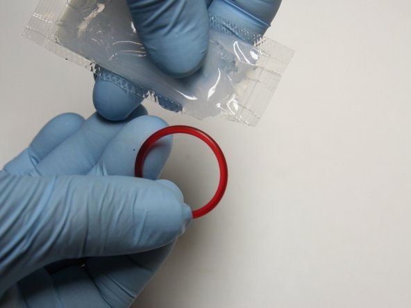

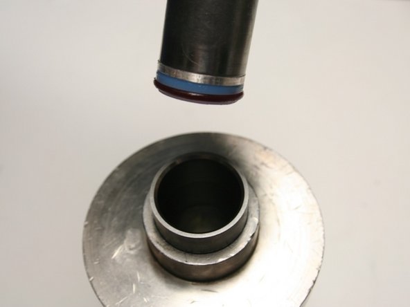

  7. Put the O-ring onto the seal. Put the hoop onto the seal with the sharp (tapered) end towards the seal. Put the seal and hoop onto the bigger stepped side of the installation tool.
    • Put the O-ring onto the seal.
  8. Put the installation tool with the hoop and seal into the sleeve. Secure the hoop in place by tapping the installation tool with a rubber mallet until the tool bottoms out on the guide.
    • Put the installation tool with the hoop and seal into the sleeve.
    • Proceed to the installation of the high-pressure cylinder on the intensifier.
