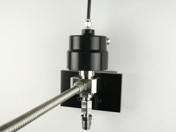

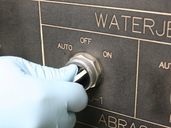

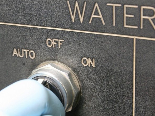

  1. Always make sure all high-pressure water has been removed from the valve by following the machine manufacturers' safety instructions. Failure to do so can cause severe injury or death. Turn OFF all water pressure to the on/off valve.
    • Always make sure all high-pressure water has been removed from the valve by following the machine manufacturers' safety instructions. Failure to do so can cause severe injury or death.
    • Turn the on/off valve ON to raise the needle from the seat.

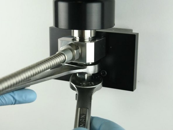

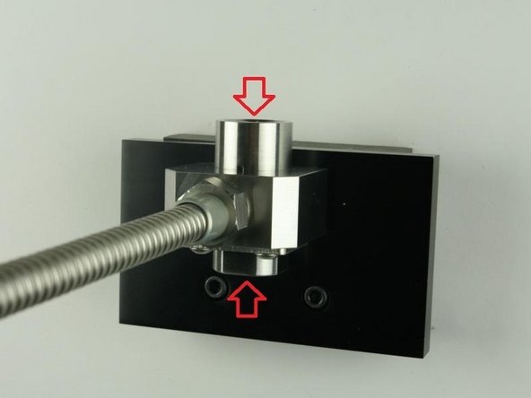

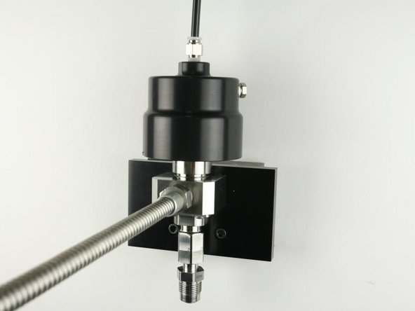

  2. The components can be replaced with the valve body in the mounting collar. Loosen the adapter from the valve body using a 1" and 13/16" wrench. Unthread the adapter from the valve body.
    • The components can be replaced with the valve body in the mounting collar.
    • Loosen the adapter from the valve body using a 1" and 13/16" wrench.
    • Unthread the adapter from the valve body.

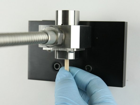

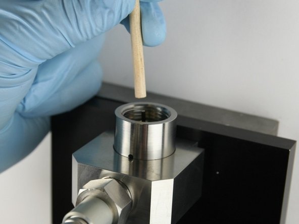

  4. Remove all the valve components using the included dowel. Thoroughly clean the interior/exterior of the valve body with isopropyl alcohol before replacing the components. Put the top and bottom of the bore for cracks/blemishes. If excessive wear or cracks are visible, replace the valve body.
    • Remove all the valve components using the included dowel.

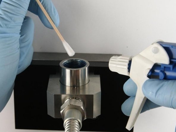

    • Thoroughly clean the interior/exterior of the valve body with isopropyl alcohol before replacing the components.
    • Put the top and bottom of the bore for cracks/blemishes. If excessive wear or cracks are visible, replace the valve body.

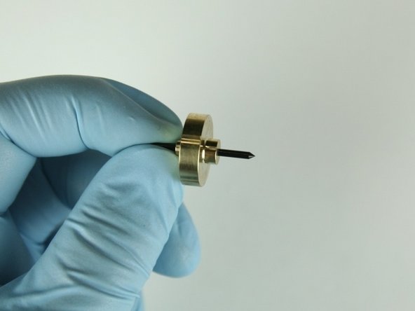

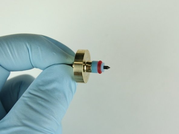

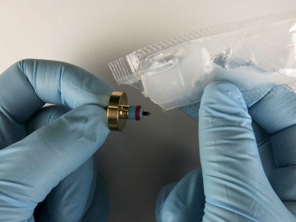

  5. Slide the needle bearing onto the needle point with the larger stepped side pointing towards the needle point. Slide the high-pressure valve seal onto the needle point. Apply a high-pressure lubricant to the outside diameter of the high-pressure valve seal.
    • Slide the needle bearing onto the needle point with the larger stepped side pointing towards the needle point.
    • Slide the high-pressure valve seal onto the needle point.
    • Apply a high-pressure lubricant to the outside diameter of the high-pressure valve seal.

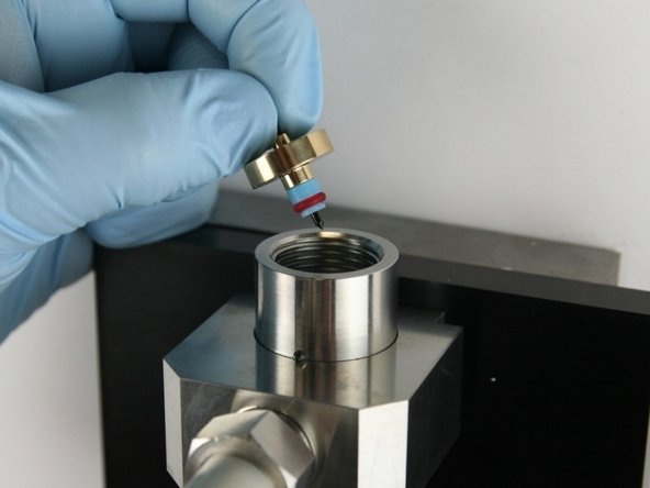

  6. Put the needle point at the top of the valve body. Use the dowel to push the needle into the valve body until the needle bearing bottoms out.
    • Put the needle point at the top of the valve body.
    • Use the dowel to push the needle into the valve body until the needle bearing bottoms out.

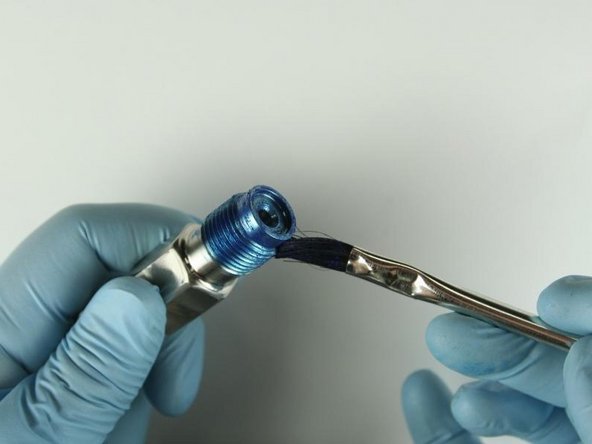

    • Apply Blue Goop to the actuator threads.

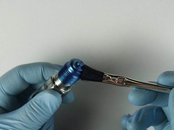

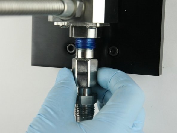

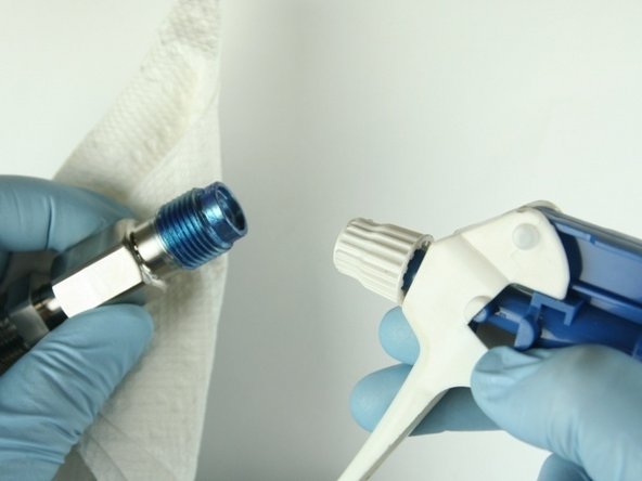

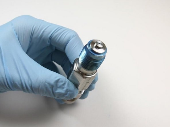

  8. Clean the adapter of all Blue Goop with isopropyl alcohol or a similar cleaning agent. Re-apply Blue Goop to the top threads and to the top of the adapter. Put the seat in the adapter with the flat the side toward the adapter.
    • Clean the adapter of all Blue Goop with isopropyl alcohol or a similar cleaning agent.
    • Re-apply Blue Goop to the top threads and to the top of the adapter.
    • Put the seat in the adapter with the flat the side toward the adapter.
  9. Apply Blue Goop to the top of the seat. Turn the air to the actuator ON. Thread the adapter into the valve body.
    • Apply Blue Goop to the top of the seat.
    • Turn the air to the actuator ON.
    • Thread the adapter into the valve body.

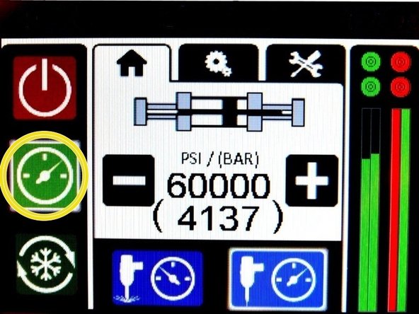

  10. Tighten the adapter into the valve body using a 1" and 13/16" wrench. Turn the air to the actuator OFF. Apply water pressure to the valve assembly to verify there are no leaks.
    • Tighten the adapter into the valve body using a 1" and 13/16" wrench.
    • Turn the air to the actuator OFF.
    • Apply water pressure to the valve assembly to verify there are no leaks.
