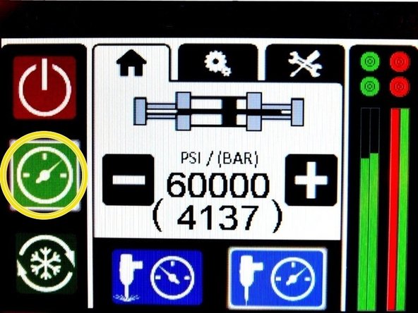

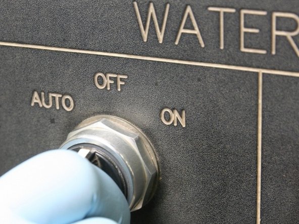

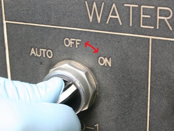

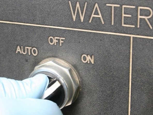

  1. Always make sure all high-pressure water has been removed from valve by following machine manufacturers' safety instructions. Failure to do so can cause severe injury or death. Turn OFF all water pressure to the on/off valve.
    • Turn the on/off valve ON to raise the needle from the accu seat.

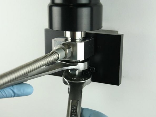

  2. Components can be replaced with the valve body in the mounting collar. Loosen the adapter from the valve body using 1" and 13/16" wrench. Unthread the adapter from the valve body.
    • Components can be replaced with the valve body in the mounting collar.
    • Loosen the adapter from the valve body using 1" and 13/16" wrench.
    • Unthread the adapter from the valve body.

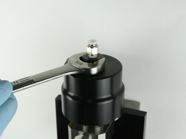

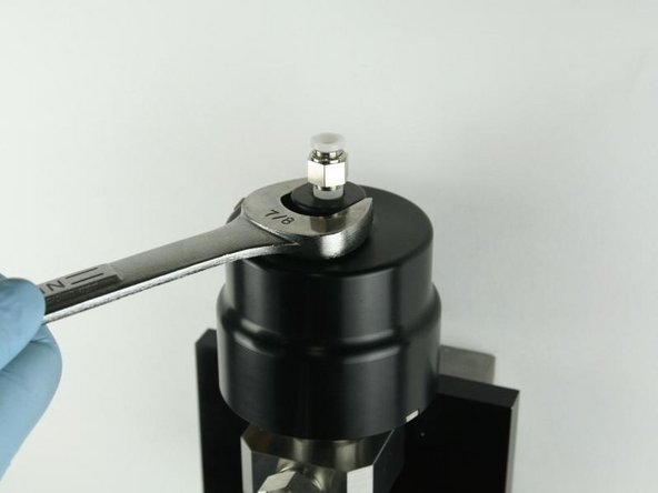

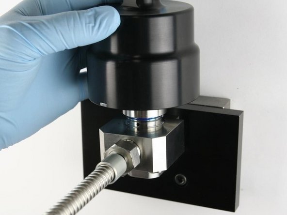

  3. Turn the air to the actuator OFF. Disconnect the air line from the actuator. Loosen the actuator from the valve body using a 7/8" wrench.
    • Turn the air to the actuator OFF.
    • Disconnect the air line from the actuator.
    • Loosen the actuator from the valve body using a 7/8" wrench.

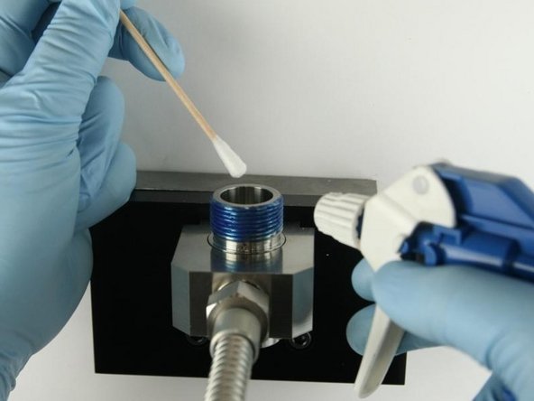

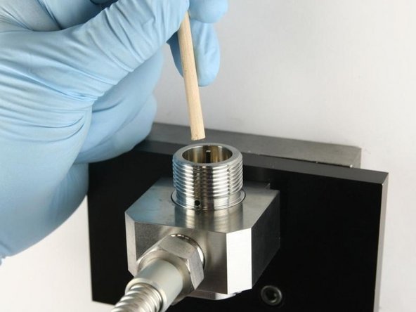

  4. Unthread the actuator from the valve body. Remove all the valve components from the valve body using the included dowel. Thoroughly clean the interior/exterior of the valve body with isopropyl alcohol before replacing the components.
    • Unthread the actuator from the valve body.
    • Remove all the valve components from the valve body using the included dowel.
    • Thoroughly clean the interior/exterior of the valve body with isopropyl alcohol before replacing the components.

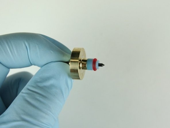

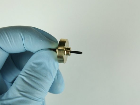

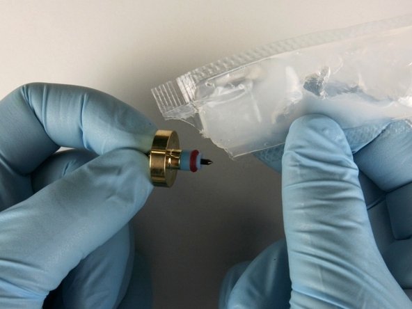

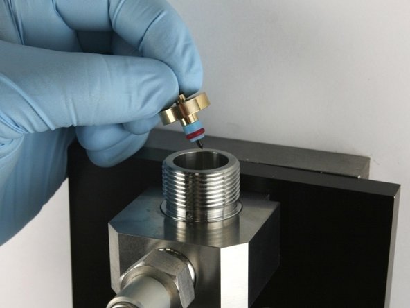

  5. Check the top and bottom of the bore for cracks/blemishes. If excessive wear or cracks are visible, replace the valve body. Slide the needle bearing  onto the needle point with the smaller step away from the needle point. Slide the high-pressure valve seal onto the needle point with the O-ring away from the needle bearing.
    • Check the top and bottom of the bore for cracks/blemishes. If excessive wear or cracks are visible, replace the valve body.
    • Slide the needle bearing onto the needle point with the smaller step away from the needle point.
    • Slide the high-pressure valve seal onto the needle point with the O-ring away from the needle bearing.

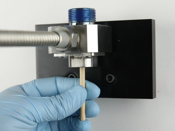

  6. Apply a high-pressure lubricant to the outside diameter of the high-pressure valve seal. Put the needle point at the top of the valve body. Use the dowel to push the needle in the valve body until the needle bearing bottoms out.
    • Apply a high-pressure lubricant to the outside diameter of the high-pressure valve seal.
    • Put the needle point at the top of the valve body.
    • Use the dowel to push the needle in the valve body until the needle bearing bottoms out.

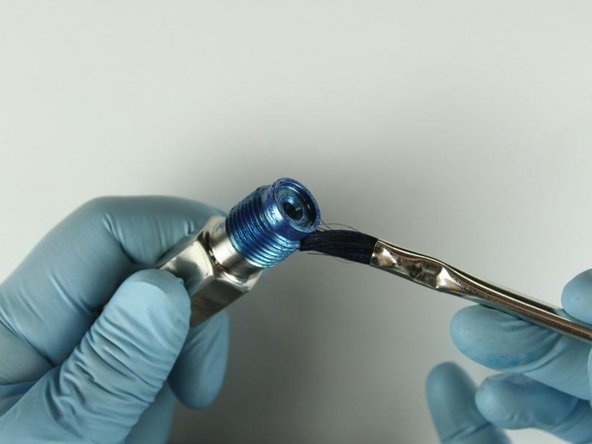

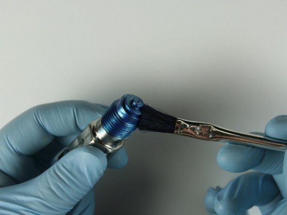

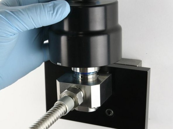

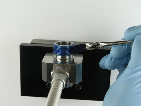

  7. Apply Blue Goop to the top threads of the valve body. Thread the actuator onto the valve body. Tighten the actuator to the valve body using a 7/8" wrench.
    • Apply Blue Goop to the top threads of the valve body.
    • Thread the actuator onto the valve body.
    • Tighten the actuator to the valve body using a 7/8" wrench.

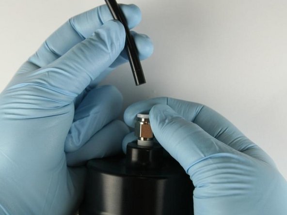

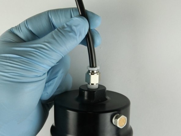

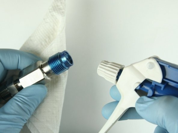

  8. Reconnect the air line to the top of the actuator. Clean the adapter of all blue goop with isopropyl alcohol or similar cleaning agent. Reapply Blue Goop to the top threads and to the top of the adapter.
    • Reconnect the air line to the top of the actuator.
    • Clean the adapter of all blue goop with isopropyl alcohol or similar cleaning agent.
    • Reapply Blue Goop to the top threads and to the top of the adapter.

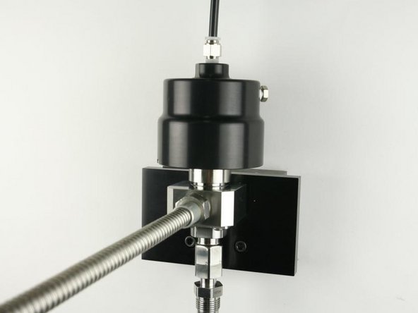

  10. Thread the adapter into the valve body. Tighten the adapter into the valve body using a 1" and 13/16" wrench. Turn the air to the actuator OFF.
    • Thread the adapter into the valve body.
    • Tighten the adapter into the valve body using a 1" and 13/16" wrench.
  11. Apply water pressure to the valve assembly to verify there are no leaks Quickly cycle the valve on and off a few times to purge the system of all contaminants before installing cutting head Reinstall cutting head and continue the cutting process.
    • Apply water pressure to the valve assembly to verify there are no leaks
    • Quickly cycle the valve on and off a few times to purge the system of all contaminants before installing cutting head
    • Reinstall cutting head and continue the cutting process.
