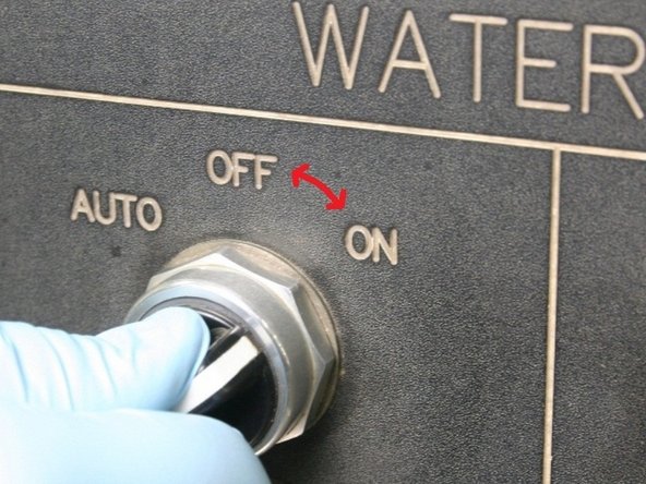

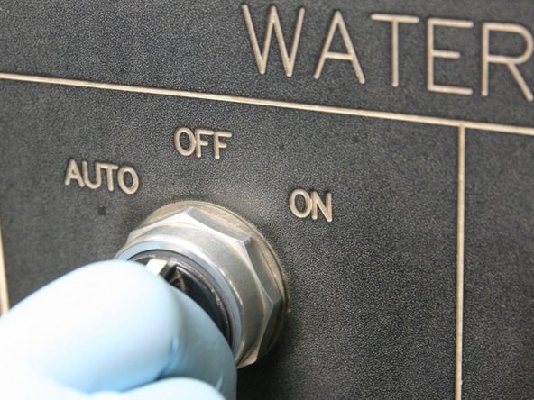

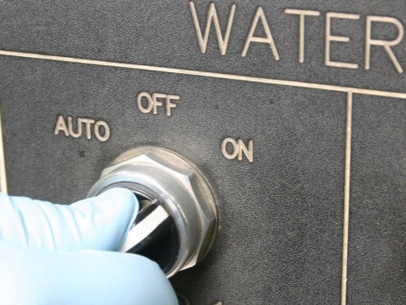

  1. Always make sure all high-pressure water has been removed from valve by following machine manufacturers' safety instructions. Failure to do so can cause severe injury or death. Turn OFF all water pressure to the on/off valve.
    • Turn the on/off valve ON to raise poppet stem from the poppet seat.

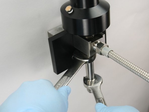

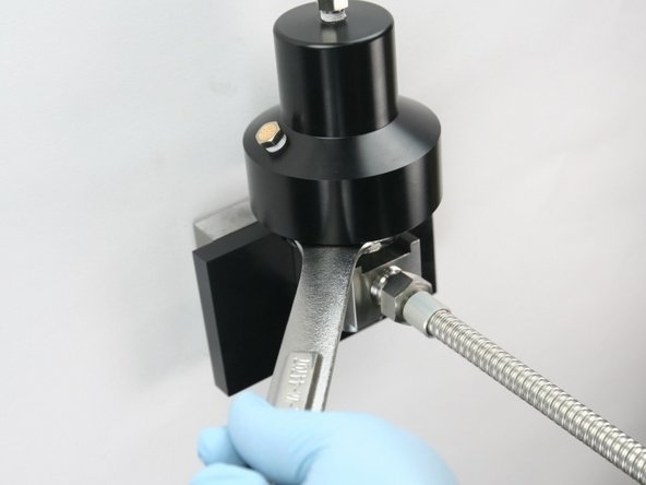

  2. The valve kit components can be replaced with the  valve body in the mounting collar. Unthread the nozzle tube from the valve body using 3/4" and 7/8" wrench.
    • The valve kit components can be replaced with the valve body in the mounting collar.
    • Unthread the nozzle tube from the valve body using 3/4" and 7/8" wrench.

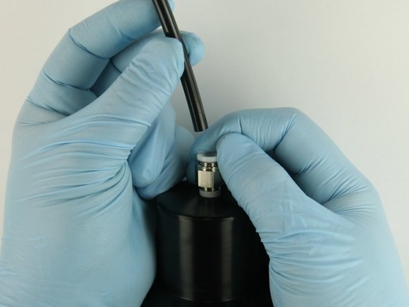

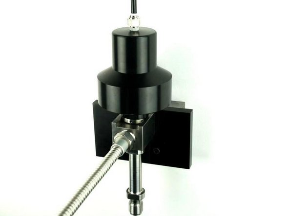

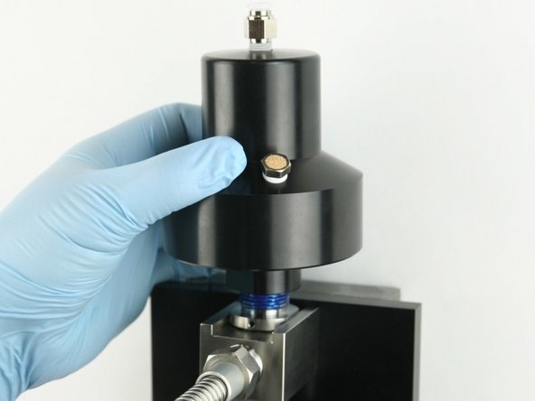

  3. Turn the air to the cctuator OFF at the controls. Disconnect the air line from the actuator. Unthread the actuator from the valve body using 1-1/8" wrench.
    • Turn the air to the cctuator OFF at the controls.
    • Disconnect the air line from the actuator.
    • Unthread the actuator from the valve body using 1-1/8" wrench.

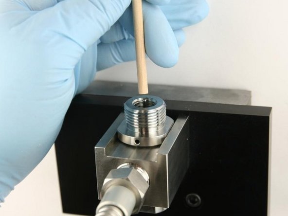

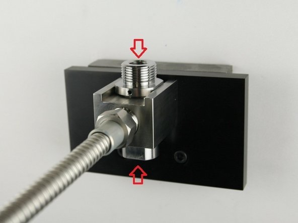

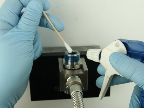

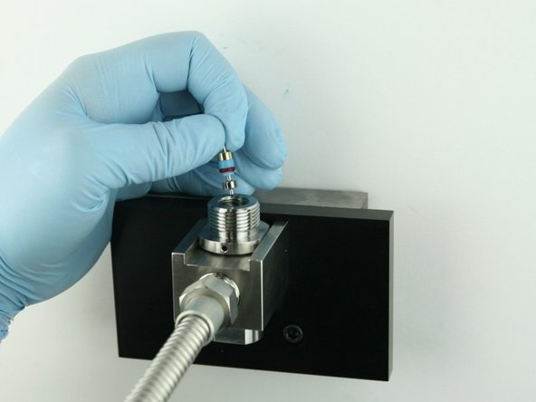

  4. Remove the old valve components from the valve body with the included dowel. Thoroughly clean the interior/exterior of the valve body with isopropyl alcohol or a similar cleaning agent before replacing the components. Visually inspect the top and bottom of the bore for cracks/blemishes.  If excessive wear or cracks are visible, replace the valve body.
    • Remove the old valve components from the valve body with the included dowel.
    • Thoroughly clean the interior/exterior of the valve body with isopropyl alcohol or a similar cleaning agent before replacing the components.
    • Visually inspect the top and bottom of the bore for cracks/blemishes. If excessive wear or cracks are visible, replace the valve body.

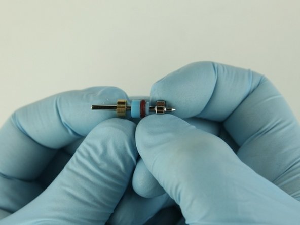

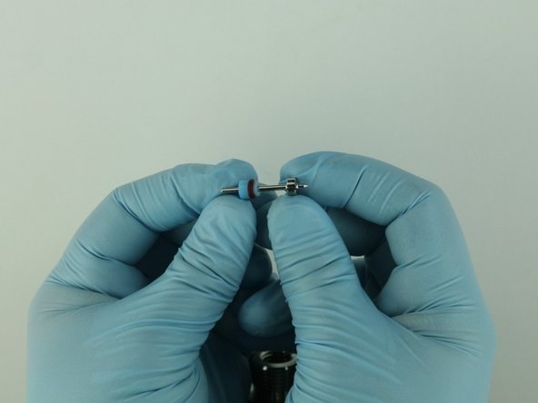

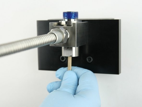

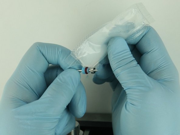

  5. With the O-ring towards the point of the poppet stem, slide the  high-pressure valve seal on to the poppet stem. Apply a high-pressure lubricant or similar (11136) to the  outside diameter of the high-pressure valve seal. Slide the back-up ring on to the poppet stem behind the high-pressure valve seal.
    • With the O-ring towards the point of the poppet stem, slide the high-pressure valve seal on to the poppet stem.
    • Apply a high-pressure lubricant or similar (11136) to the outside diameter of the high-pressure valve seal.
    • Slide the back-up ring on to the poppet stem behind the high-pressure valve seal.

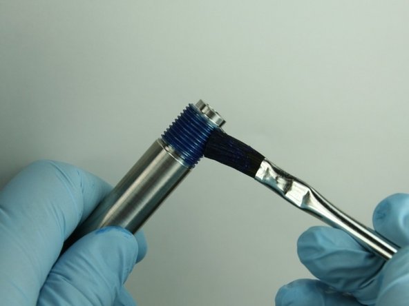

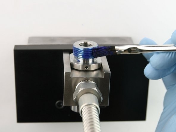

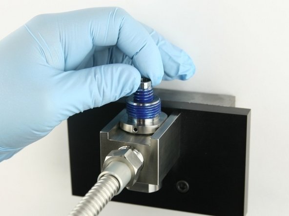

  6. Put the poppet stem, with the point down, at the top of the valve body. Use the dowel to push the poppet stem down until the back-up ring is flush with the top of the bore. Apply  Blue Goop to the top threads of the valve body.
    • Put the poppet stem, with the point down, at the top of the valve body.
    • Use the dowel to push the poppet stem down until the back-up ring is flush with the top of the bore.
    • Apply Blue Goop to the top threads of the valve body.

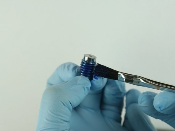

  7. Apply Blue Goop to the  valve screw threads. Thread the valve screw into the valve body until it bottoms out. With the dowel, push the poppet stem point flush with the bottom of the bore.
    • Apply Blue Goop to the valve screw threads.
    • Thread the valve screw into the valve body until it bottoms out.
    • With the dowel, push the poppet stem point flush with the bottom of the bore.

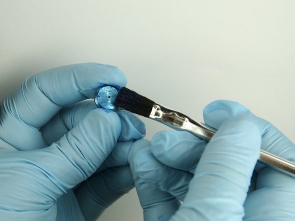

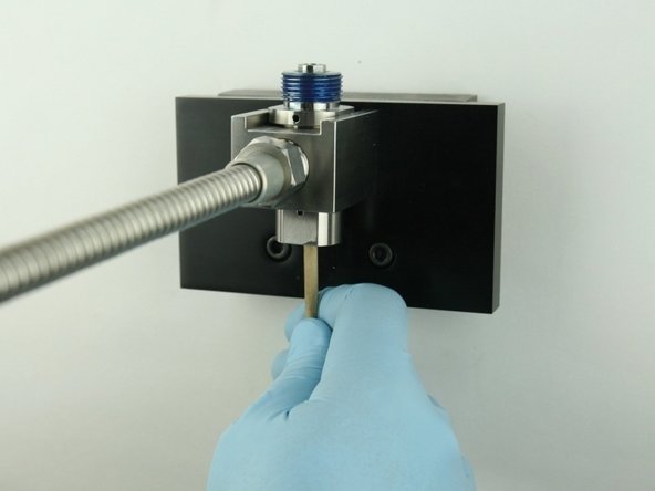

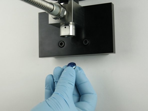

  8. Apply Blue Goop to all surfaces of the poppet seat. Put the poppet seat at bottom of the valve body. Put the  O-ring behind the poppet seat so it is held in place.
    • Apply Blue Goop to all surfaces of the poppet seat.
    • Put the poppet seat at bottom of the valve body.

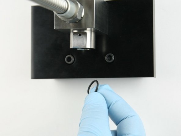

    • Put the O-ring behind the poppet seat so it is held in place.

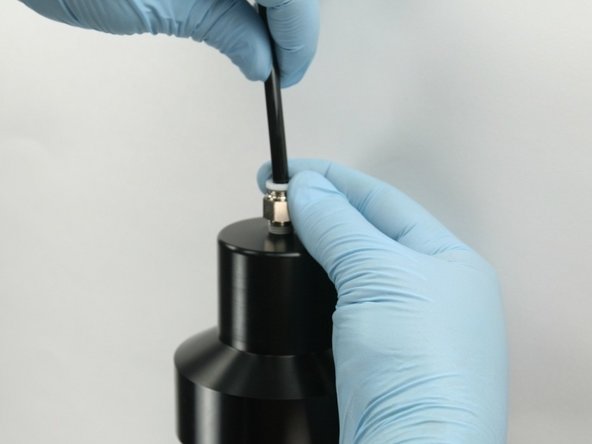

  9. Thread (hand tighten) the actuator on top of the valve body. Reconnect the air line to the top of the actuator. Turn the air to the actuator ON to relieve the pressure from the poppet.
    • Thread (hand tighten) the actuator on top of the valve body.
    • Reconnect the air line to the top of the actuator.
    • Turn the air to the actuator ON to relieve the pressure from the poppet.

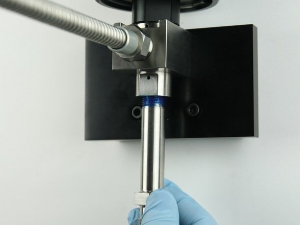

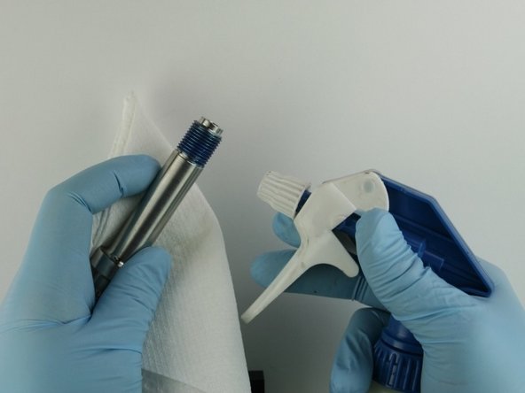

  10. Thoroughly clean the nozzle tube of all Blue Goop. Reapply Blue Goop to the threads of the nozzle tube. Thread the nozzle tube into the bottom of the valve body.
    • Thoroughly clean the nozzle tube of all Blue Goop.
    • Reapply Blue Goop to the threads of the nozzle tube.
    • Thread the nozzle tube into the bottom of the valve body.
  11. Tighten the nozzle tube to the valve bodye using 3/4" and 7/8" wrench. Turn the air to the actuator OFF to set the poppet stem into the poppet seat. Apply water pressure to the valve assembly to verify that there are no leaks.
    • Tighten the nozzle tube to the valve bodye using 3/4" and 7/8" wrench.
    • Turn the air to the actuator OFF to set the poppet stem into the poppet seat.
    • Apply water pressure to the valve assembly to verify that there are no leaks.
