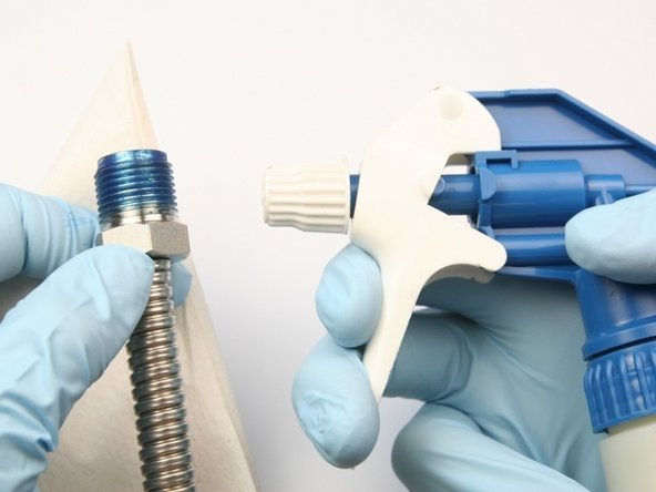

Clean 3/8" gland nut of all blue goop with isopropyl alcohol

Clean outlet adapter of all blue goop with isopropyl alcohol

Clean seal back-up screw with isopropyl alcohol

Clean bleed down valve body with isopropyl alcohol or similar
