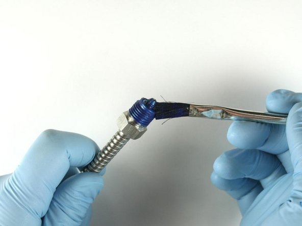

  15. Apply high vacuum grease to exterior of HP seal, hoop, and bushing Apply high vacuum grease to internal threads of bleed down valve body Insert high pressure needle assembly into top of bleed down valve body with point first

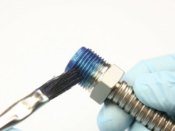

  16. Push seal backup screw inside of valve body until it bottoms out Take seal backup screw out of body and apply a layer of blue goop to threads Thread in back-up screw into top of bleed down valve body
  17. Tighten back-up screw to top of bleed down valve body using a 5/16" socket wrench Place flow reducer into hole beneath seat cavity in outlet adapter Apply a layer of blue goop to external threads and seat cavity of outlet adapter

  18. Place poppet seat into seat cavity of outlet adapter Apply a layer of blue goop to top of poppet seat sitting in outlet adapter Thread outlet adapter into valve body
  19. Using a 1" wrench on outlet adapter and a 7/8" wrench on the valve body, tighten securely Apply a layer of blue goop to external threads of valve body Thread actuator housing onto valve body
  20. Tighten using a 1-1/16" wrench on actuator housing and a 7/8" wrench on valve body Apply blue goop to 3/8" gland nut threads Thread 3/8" gland nut with HP tubing into bleed down valve adapter
    • Apply blue goop to 3/8" gland nut threads
    • Thread 3/8" gland nut with HP tubing into bleed down valve adapter
  21. Tighten gland nut into bleed down valve adapter using 13/16" and 5/8" wrench Apply blue goop to 1/4" gland nut threads Thread 1/4" gland nut into side of bleed down valve body
