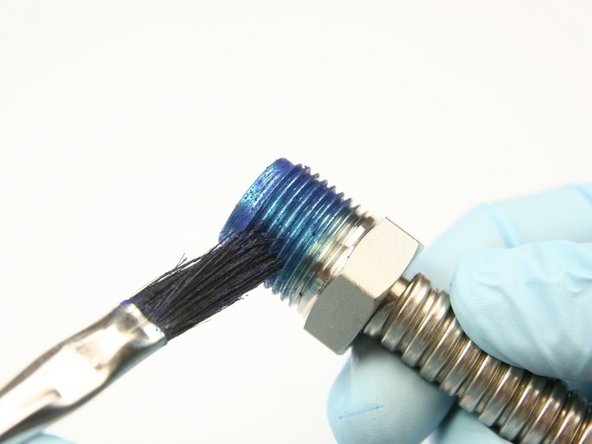

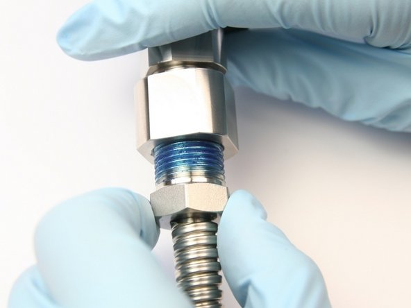

  21. Apply blue goop to gland nut threads Thread in gland nut with HP tubing into bleed down valve adapter Tighten gland nut into bleed down valve adapter using 13/16" and 5/8" wrench
    • Apply blue goop to gland nut threads
    • Tighten gland nut into bleed down valve adapter using 13/16" and 5/8" wrench
