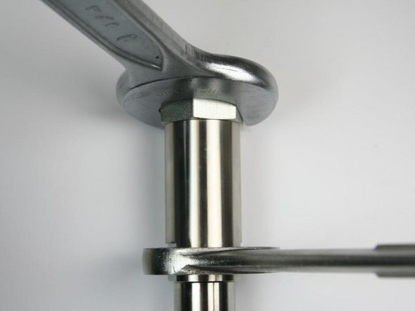

  20. Using a 1" wrench on outlet adapter and a 7/8" wrench on the valve body, tighten securely Apply a layer of blue goop to external threads of valve body Thread actuator housing onto valve body
  21. Tighten using a 1-1/16" wrench on actuator housing and a 7/8" wrench on valve body Thread in bleed down valve adapter to bleed down valve outlet Tighten bleed down valve adapter to bleed down valve outlet using 1" and 7/8" wrench
