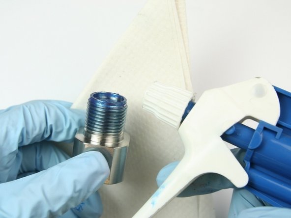

  3. Clean gland nut of all blue goop with isopropyl alcohol loosen gland nut from outlet fitting (connected to valve body) using 13/16" and 5/8" wrench Unthread gland nut from outlet fitting (connected to valve body)
    • loosen gland nut from outlet fitting (connected to valve body) using 13/16" and 5/8" wrench
    • Unthread gland nut from outlet fitting (connected to valve body)
  4. Clean gland nut of all blue goop with isopropyl alcohol Loosen hydraulic fitting from adapter fitting using 1-1/4" and 7/8" wrench Unthread hydraulic fitting from adapter fitting

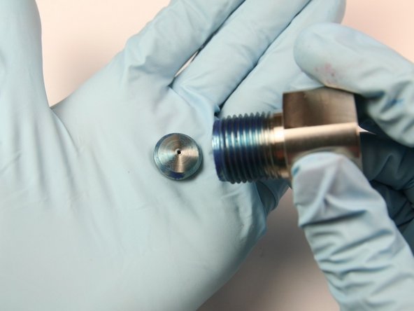

  11. Unthread outlet fitting from bleed down valve body Remove HP Seat from bleed down valve body Remove Flow Reducer from outlet adapter
    • Remove HP Seat from bleed down valve body

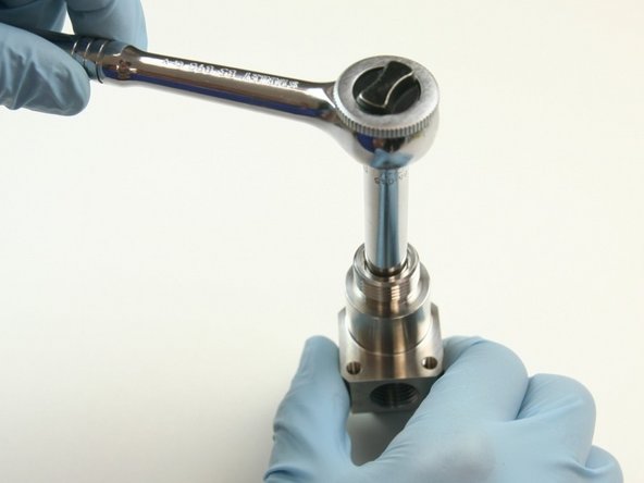

  12. Clean outlet adapter of all blue goop with isopropyl alcohol Discard seat Loosen back-up screw from top of bleed down valve body using a 5/16" ratchet
    • Discard seat
    • Loosen back-up screw from top of bleed down valve body using a 5/16" ratchet
  13. Clean bleed down valve body with isopropyl alcohol Apply high vacuum grease to Needle Slide back-up screw on to needle to flat end of needle is flush with non threaded part of back-up screw

  16. Push seal backup screw inside of valve body until it bottoms out Take seal backup screw out of body and apply a layer of blue goop to threads Thread in back-up screw into top of bleed down valve body
  17. Tighten back-up screw to top of bleed down valve body using a 5/16" ratchet Place flow reducer into hole beneath seat cavity in the outlet adapter Apply a layer of blue goop to external threads and seat cavity of outlet adapter
  18. Place poppet seat into seat cavity of outlet adapter Apply a layer of blue goop to top of poppet seat sitting in outlet adapter Thread outlet adapter into valve body
