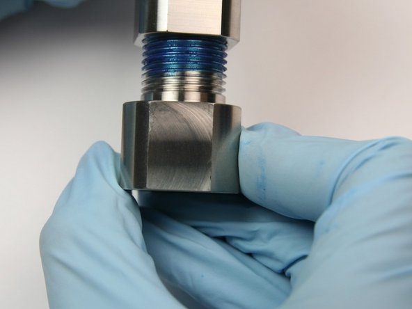

  3. Clean gland nut of all blue goop with isopropyl alcohol loosen gland nut from outlet fitting (connected to valve body) using 13/16" and 5/8" wrench Unthread gland nut from outlet fitting (connected to valve body)
    • loosen gland nut from outlet fitting (connected to valve body) using 13/16" and 5/8" wrench
    • Unthread gland nut from outlet fitting (connected to valve body)
  4. Clean gland nut of all blue goop with isopropyl alcohol Loosen hydraulic fitting from adapter fitting using 1-1/4" and 7/8" wrench Unthread hydraulic fitting from adapter fitting

  20. Apply blue goop to gland nut Thread in gland nut with HP tubing into bleed down valve adapter
    • Apply blue goop to gland nut
    • Tighten gland nut into bleed down valve adapter using......
  21. Apply blue goop to gland nut Thread in gland nut to side of bleed down valve body
    • Tighten gland nut to side of bleed down valve body with....
