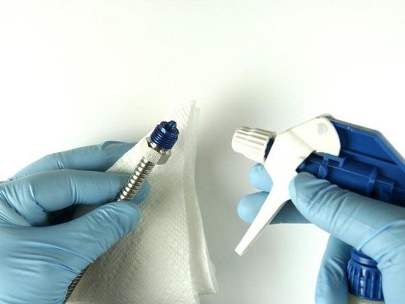

  3. Clean gland nut of all blue goop with isopropyl alcohol loosen gland nut from outlet fitting (connected to valve body) using 13/16" and 5/8" wrench Unthread gland nut from outlet fitting (connected to valve body)

  4. Clean gland nut of all blue goop with isopropyl alcohol Loosen hydraulic fitting from adapter fitting using 1-1/4" and 7/8" wrench Unthread hydraulic fitting from adapter fitting
