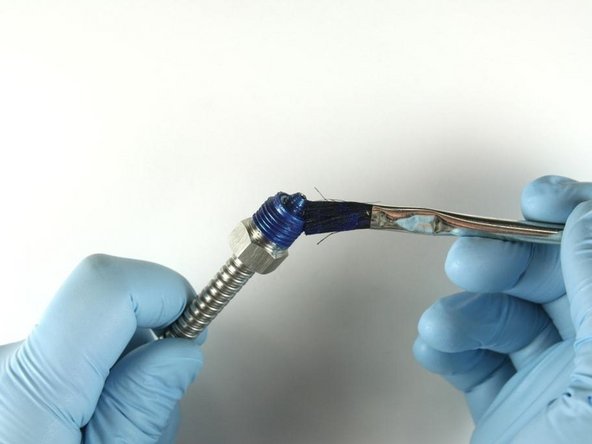

  13. Push seal backup screw inside of valve body until it bottoms out Take seal backup screw out of body and apply a layer of blue goop to threads Thread in back-up screw into top of bleed down valve body

  18. Apply blue goop to gland nut Thread in gland nut with HP tubing into bleed down valve adapter
    • Apply blue goop to gland nut
    • Tighten gland nut into bleed down valve adapter using......
  19. Apply blue goop to gland nut Thread in gland nut to side of bleed down valve body
    • Tighten gland nut to side of bleed down valve body with....
