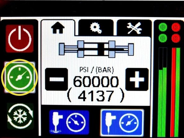

  21. Turn pump ON and continue cutting process
