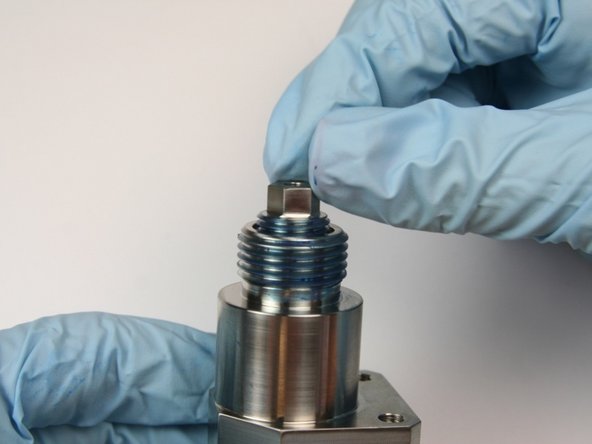

  10. Clean bleed down valve body with isopropyl alcohol Apply high vacuum grease to Needle Slide back-up screw on to needle to flat end of needle is flush with non threaded part of back-up screw
  11. Slide bushing onto point of needle with chamfered end towards back-up screw Place hoop with tapered end onto non o-ring side of HP Seal Place HP seal assembly onto point of needle with hoop first
  12. Apply high vacuum grease to exterior of HP seal, hoop, and bushing Apply high vacuum grease to internal threads of bleed down valve body Insert high pressure needle assembly into top of bleed down valve body with point first
  13. Push seal backup screw inside of valve body until it bottoms out Take seal backup screw out of body and apply a layer of blue goop to threads Thread in back-up screw into top of bleed down valve body
  14. Tighten back-up screw to top of bleed down valve body using a 5/16" ratchet Place flow reducer into hole beneath seat cavity in the outlet adapter

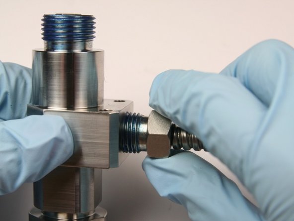

  18. Apply blue goop to gland nut Thread in gland nut with HP tubing into bleed down valve adapter
    • Apply blue goop to gland nut
  19. Thread in gland nut to side of bleed down valve body Tighten gland nut to side of bleed down valve body with....
    • Tighten gland nut to side of bleed down valve body with....
