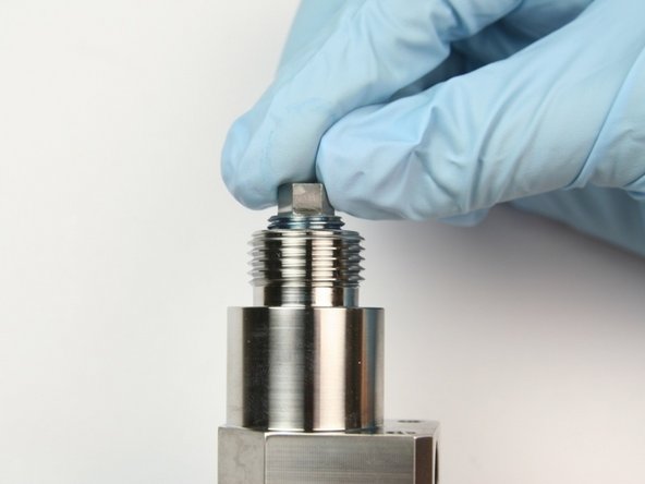

  13. Unthread seal back-up screw from top of bleed down valve body Push components through bleed down valve body with included dowel Clean bleed down valve body with isopropyl alcohol
  14. Apply high vacuum grease to Needle Slide back-up screw on to needle to flat end of needle is flush with non threaded part of back-up screw Slide bushing onto point of needle with chamfered end towards back-up screw
  15. Place hoop with tapered end onto non o-ring side of HP Seal Place HP seal assembly onto point of needle with hoop first Apply high vacuum grease to exterior of HP seal, hoop, and bushing
  16. Apply high vacuum grease to internal threads of bleed down valve body Insert high pressure needle assembly into top of bleed down valve body with point first Push seal backup screw inside of valve body until it bottoms out
  17. Take seal backup screw out of body and apply a layer of blue goop to threads Thread in back-up screw into top of bleed down valve body Tighten back-up screw to top of bleed down valve body using a 5/16" ratchet
