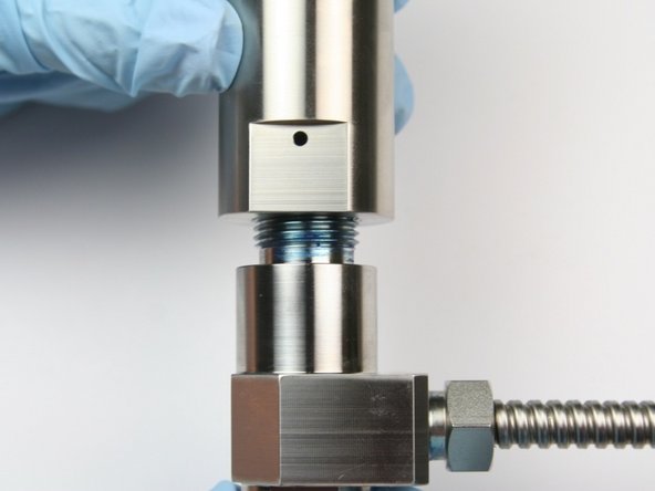

  19. Apply a layer of blue goop to top of poppet seat sitting in outlet adapter Thread outlet adapter into valve body Using a 1" wrench on outlet adapter and a 7/8" wrench on the valve body, tighten securely
  20. Apply a layer of blue goop to external threads of valve body Thread valve body into housing Tighten using a 1-1/16" wrench on housing body and a 7/8" wrench on valve body
    • Thread valve body into housing
    • Tighten using a 1-1/16" wrench on housing body and a 7/8" wrench on valve body
