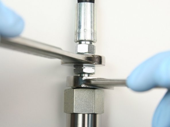

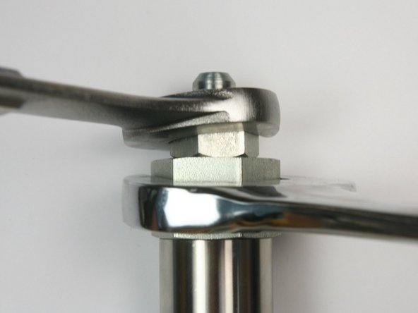

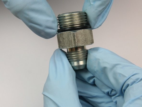

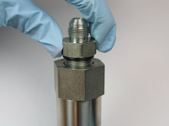

  2. Unthread hose from hydraulic fitting Loosen hydraulic fitting from Adapter Fitting 1-1/4" and 7/8" wrench Unthread hydraulic fitting from adapter fitting
    • Loosen hydraulic fitting from Adapter Fitting 1-1/4" and 7/8" wrench

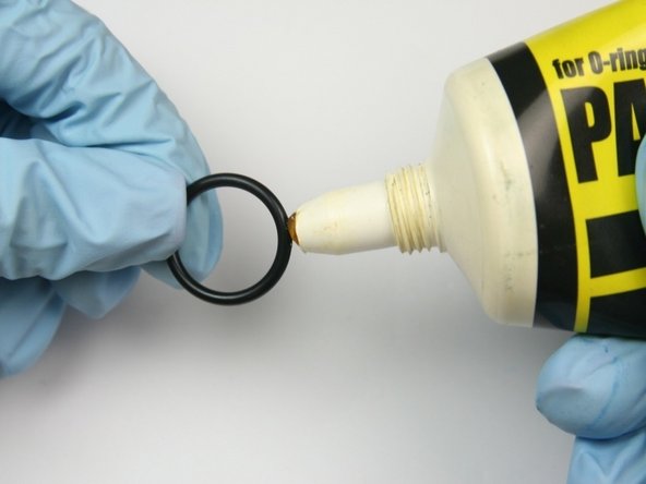

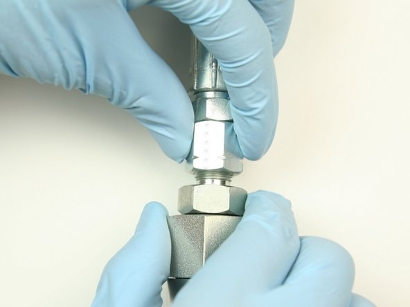

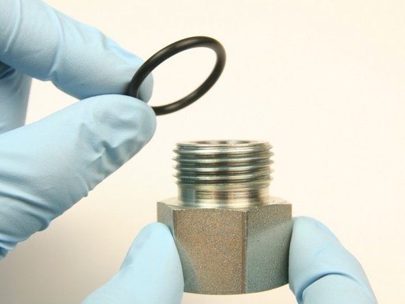

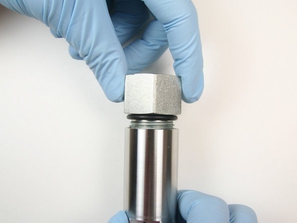

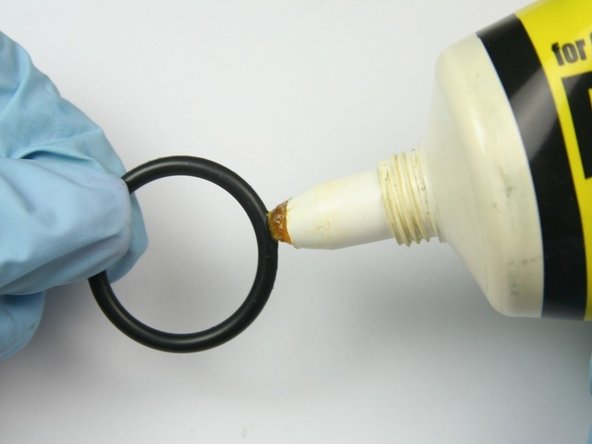

  3. Apply o-ring lubricant to o-ring from kit for hydraulic fitting Replace o-ring around hydraulic fitting with o-ring in kit (smallest o-ring in kit) Loosen adapter fitting from Actuator Housing with1-1/4" and 1-1/16" wrench
    • Loosen adapter fitting from Actuator Housing with1-1/4" and 1-1/16" wrench

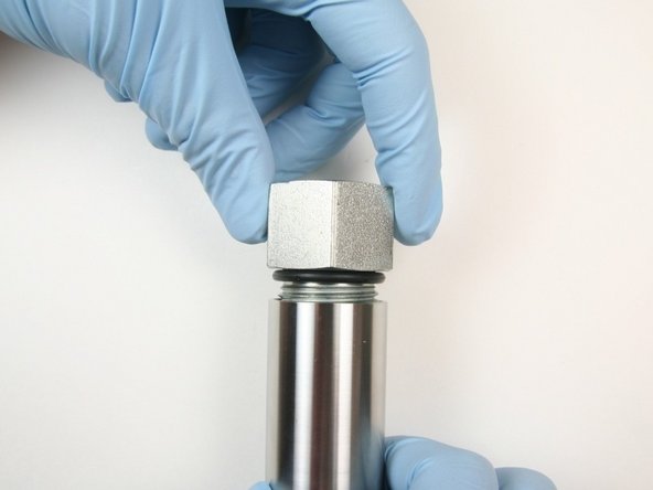

  4. Unthread adapter fitting from actuator housing Apply o-ring lubricant to largest o-ring in kit Replace o-ring on adapter fitting with largest o-ring in kit

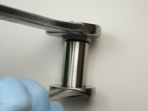

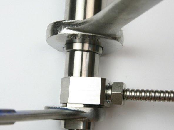

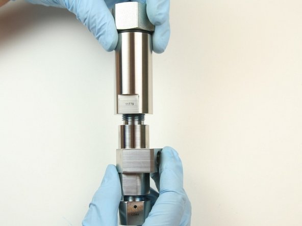

  5. Loosen actuator housing from Valve Body using 1-1/16" and 7/8" wrench Unthread actuator housing from valve body

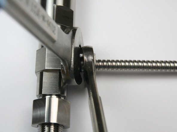

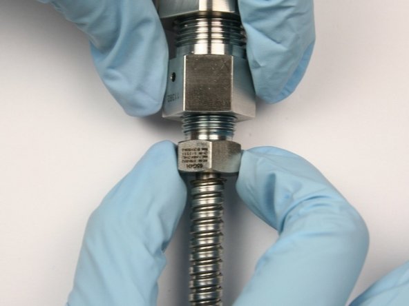

    • Loosen gland nut from Bleed Down Valve inlet using 5/8" and 3/4" wrench

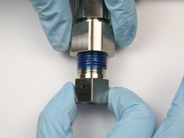

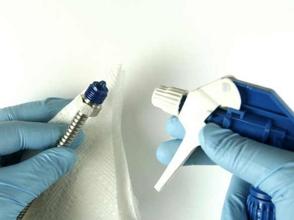

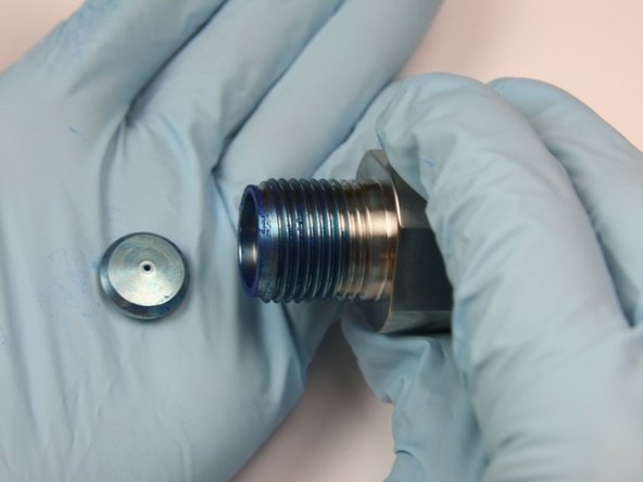

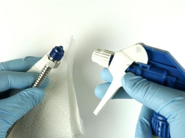

  6. Unthread gland nut with HP tubing from bleed down valve inlet Clean gland nut of all Blue Goop with isopropyl alcohol Loosen gland nut from outlet fitting using 13/16" and 5/8" wrench
    • Unthread gland nut with HP tubing from bleed down valve inlet
    • Clean gland nut of all Blue Goop with isopropyl alcohol
    • Loosen gland nut from outlet fitting using 13/16" and 5/8" wrench

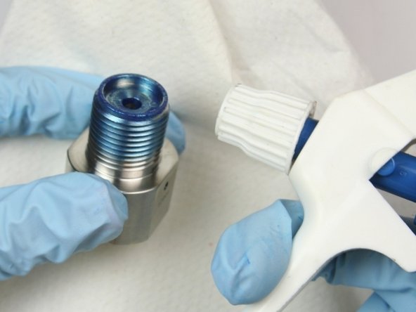

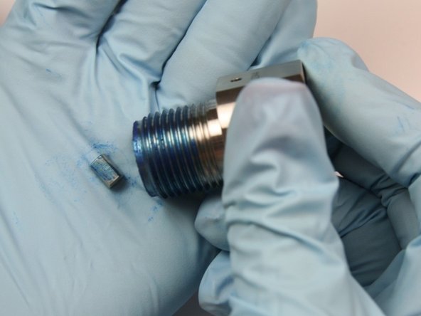

  7. Unthread gland nut from outlet adapter Clean gland nut of all blue goop with isopropyl alcohol Push Piston out of actuator housing through oil port using included dowel
    • Unthread gland nut from outlet adapter
    • Push Piston out of actuator housing through oil port using included dowel

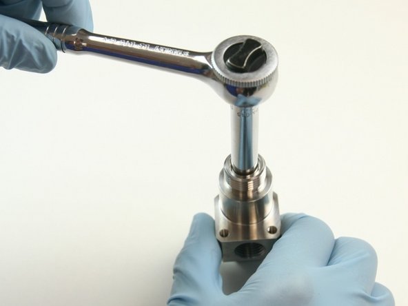

  10. Thread adapter fitting to actuator housing Tighten adapter fitting to actuator housing using 1-1/4" and 1-1/16" wrench
    • Thread adapter fitting to actuator housing
    • Tighten adapter fitting to actuator housing using 1-1/4" and 1-1/16" wrench

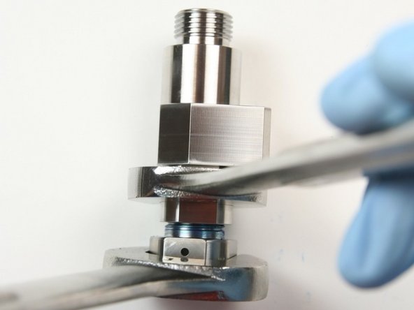

    • Loosen 3/8" to 1/4" adapter from bleed down valve outlet adapter using 1" and 13/16" wrench
  11. Unthread 3/8" to 1/4" adapter from bleed down valve adapter Loosen bleed down valve adapter outlet from bleed down valve using 7/8" and 1" wrench
    • Unthread 3/8" to 1/4" adapter from bleed down valve adapter
    • Loosen bleed down valve adapter outlet from bleed down valve using 7/8" and 1" wrench
    • Unthread bleed down valve adapter from bleed down valve

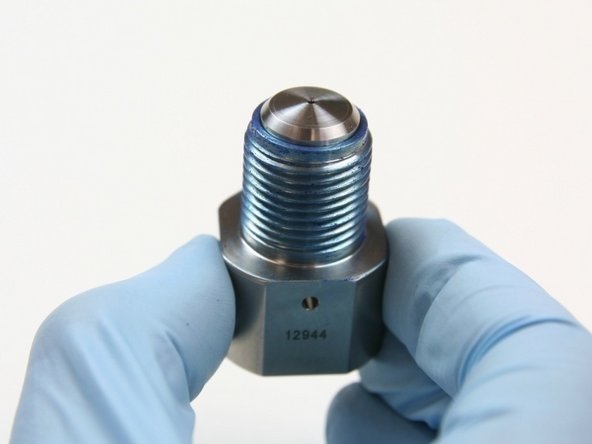

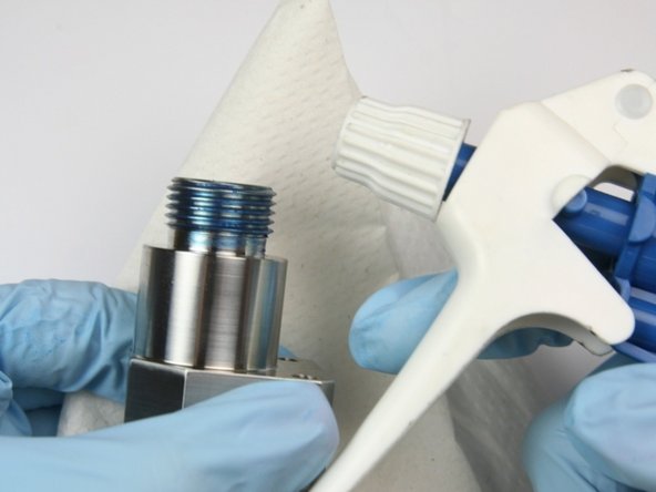

  12. Remove Seat from bleed down valve body Remove Flow Reducer from bleed down valve adapter Clean outlet adapter of all blue goop
    • Remove Seat from bleed down valve body
    • Remove Flow Reducer from bleed down valve adapter
    • Clean outlet adapter of all blue goop

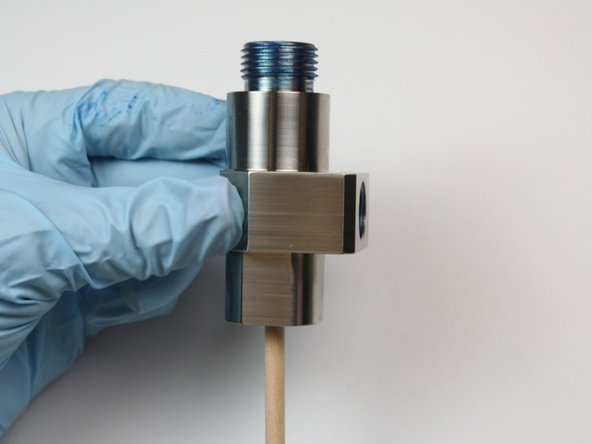

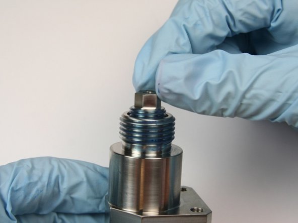

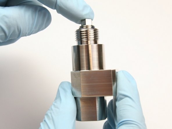

  13. Unthread seal back-up screw from top of bleed down valve body Push components through bleed down valve body with included dowel Clean bleed down valve body with isopropyl alcohol

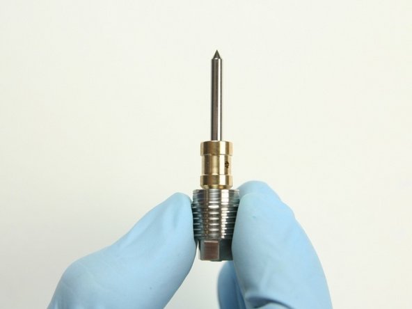

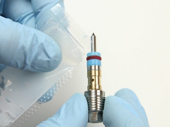

  14. Apply high vacuum grease to Needle Slide back-up screw on to needle to flat end of needle is flush with non threaded part of back-up screw Slide bushing onto point of needle with chamfered end towards back-up screw
  15. Place hoop with tapered end onto non o-ring side of HP Seal Place HP seal assembly onto point of needle with hoop first Apply high vacuum grease to exterior of HP seal, hoop, and bushing
  16. Apply high vacuum grease to internal threads of bleed down valve body Insert high pressure needle assembly into top of bleed down valve body with point first Push seal backup screw inside of valve body until it bottoms out

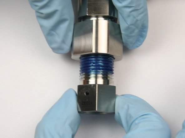

  17. Take seal backup screw out of body and apply a layer of blue goop to threads Thread in back-up screw into top of bleed down valve body Tighten back-up screw to top of bleed down valve body using a 5/16" ratchet

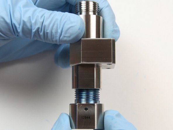

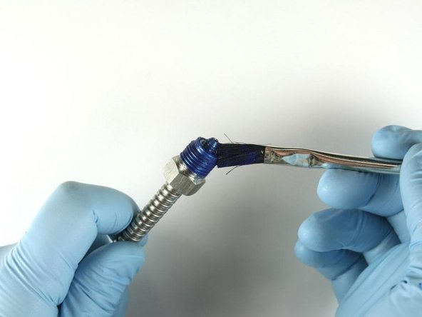

  18. Place flow reducer into hole beneath seat cavity in the outlet adapter Apply a layer of blue goop to external threads and seat cavity of outlet adapter Place poppet seat into seat cavity of outlet adapter

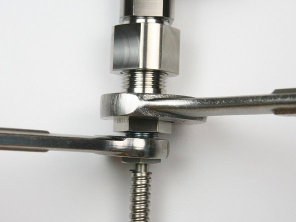

  19. Apply a layer of blue goop to top of poppet seat sitting in outlet adapter Thread outlet adapter into valve body Using a 1" wrench on outlet adapter and a 7/8" wrench on the valve body, tighten securely
  20. Apply a layer of blue goop to external threads of valve body Thread valve body into housing Using a 1 1/16" wrench on housing body and a 7/8" wrench on valve body, tighten wrench tight
    • Thread valve body into housing
    • Using a 1 1/16" wrench on housing body and a 7/8" wrench on valve body, tighten wrench tight

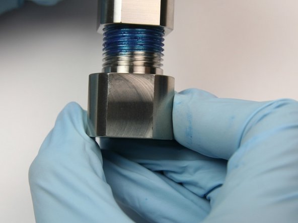

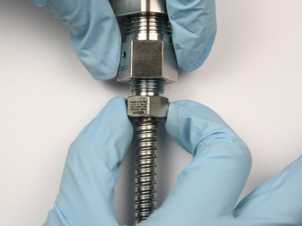

    • Apply blue goop to gland nut
  22. Thread in gland nut with HP tubing into bleed down valve adapter Apply blue goop to gland nut Thread in gland nut to side of bleed down valve body
  23. Tighten gland nut to side of bleed down valve body with.... Thread in hydraulic fitting to adapter fitting Tighten hydraulic fitting to adapter fitting using.....
    • Tighten gland nut to side of bleed down valve body with....
    • Thread in hydraulic fitting to adapter fitting
    • Tighten hydraulic fitting to adapter fitting using.....
  24. Thread hydraulic hose to hydraulic fitting Tighten hydraulic hose to hydraulic fitting using 7/8" and 3/4" wrench Turn pump ON and continue cutting process
