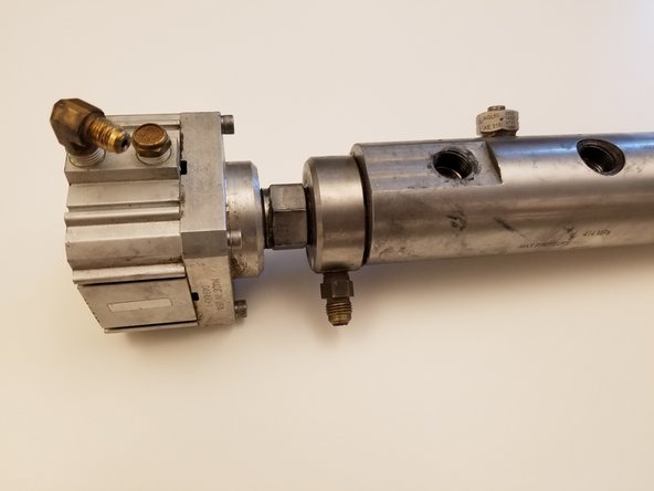

  2. Disconnect air line from actuator Disconnect PCV drain line
    • Disconnect air line from actuator
    • Disconnect PCV drain line

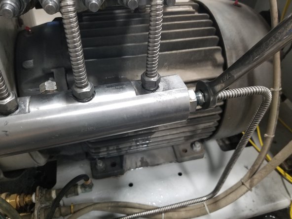

  3. Remove high-pressure tube from manifold using a 13/16" open end wrench
    • Remove high-pressure tube from manifold using a 13/16" open end wrench
    • Disconnect the three high-pressure tubes from the manifold using 13/16" open end wrench while supporting the manifold

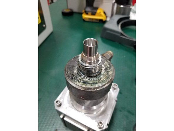

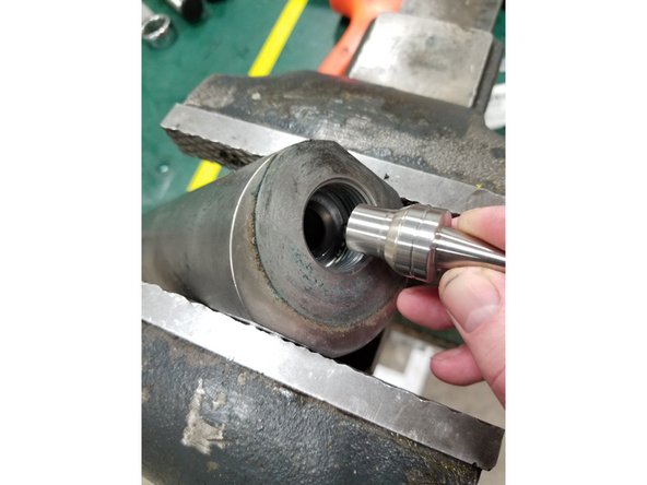

  4. With manifold removed from pump, place manifold in a heavy bench vise Remove the PCV body using a 1-1/4" (32 mm) wrench Remove the PCV body using a 1-1/4" (32 mm) wrench
    • With manifold removed from pump, place manifold in a heavy bench vise
    • Remove the PCV body using a 1-1/4" (32 mm) wrench

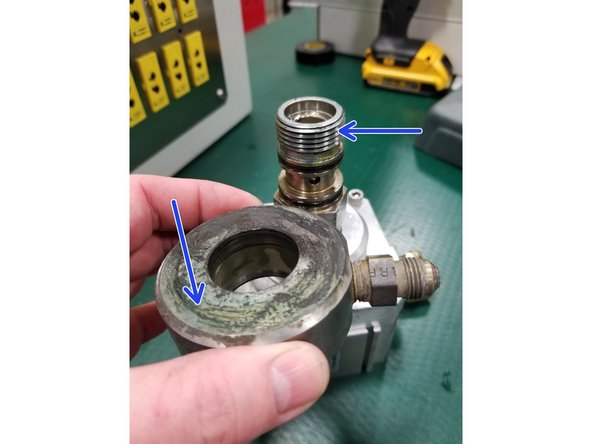

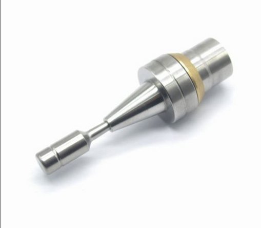

  5. Apply blue lubricant to threads and both faces of the PCV adapter Install new PCV Ring onto new PCV Seat, and insert PCV Poppet into seat. Insert PCV assembly into PCV body Thread manifold onto PCV Adapter. Torque to 190 ft-lb (258 N-m)
    • Apply blue lubricant to threads and both faces of the PCV adapter
    • Install new PCV Ring onto new PCV Seat, and insert PCV Poppet into seat. Insert PCV assembly into PCV body
    • Thread manifold onto PCV Adapter. Torque to 190 ft-lb (258 N-m)
