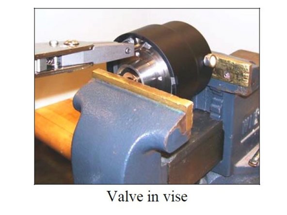

  1. Remove the air fitting from the top of the actuator Using a 5/64" Allen Wrench, remove the retainer cap from the bottom of the actuator. Place the actuator in a bench vise.  Tighten the vise enough to slightly compress the actuator springs.
    • Remove the air fitting from the top of the actuator
    • Using a 5/64" Allen Wrench, remove the retainer cap from the bottom of the actuator.
    • Place the actuator in a bench vise. Tighten the vise enough to slightly compress the actuator springs.
    • Caution: the actuator assembly contains high-force springs under compression.
    • Using the ratcheting snap ring pliers, compress and remove the snap ring that secures the actuator cap into the housing.
    • Carefully take the actuator out of the vise. All of the internal actuator components can now be removed.

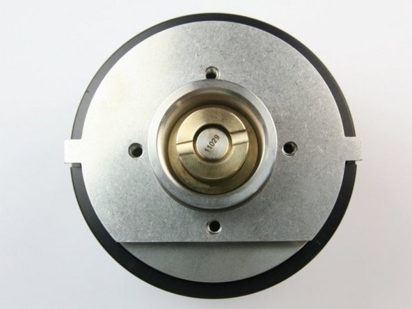

  3. After all the internal components have been re-installed, place the retainer cap with the tabs in the slots on the housing. Twist the actuator cap until the four screw holes line up with the holes in the retainer.
    • After all the internal components have been re-installed, place the retainer cap with the tabs in the slots on the housing.
    • Twist the actuator cap until the four screw holes line up with the holes in the retainer.

    • Remove the actuator from the vise. Use a 5/64 Allen wrench to tighten the four screws that hold the retainer to the actuator cap.
