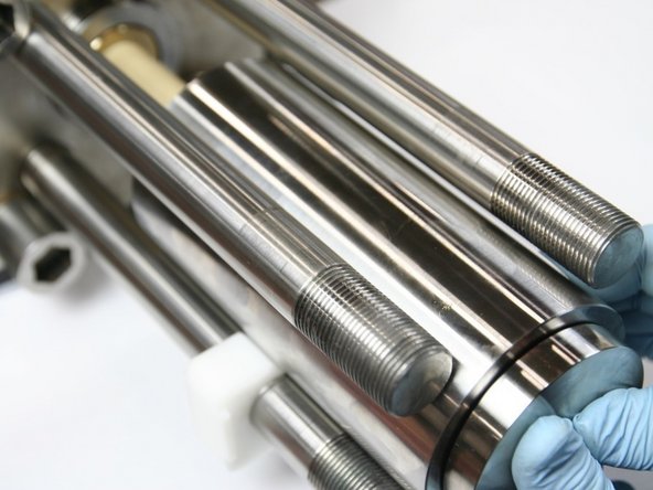

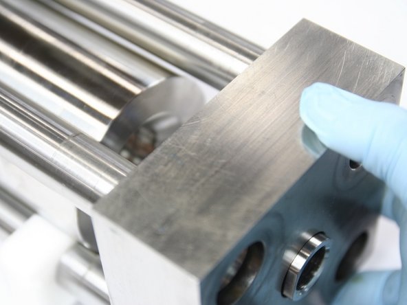

  1. Always make sure all high-pressure water has been removed from pump by following machine manufacturers' safety instructions. Failure to do so can cause severe injury or death. Remove HP cylinders and check valves from intensifier. Clean cylinders and check valves thoroughly, following standard procedures.
    • Always make sure all high-pressure water has been removed from pump by following machine manufacturers' safety instructions. Failure to do so can cause severe injury or death.
    • Remove HP cylinders and check valves from intensifier. Clean cylinders and check valves thoroughly, following standard procedures.
    • Scotch-Brite, or similar abrasive pad, can be used on sealing faces of cylinder and check valve to clean marking and/or galling.

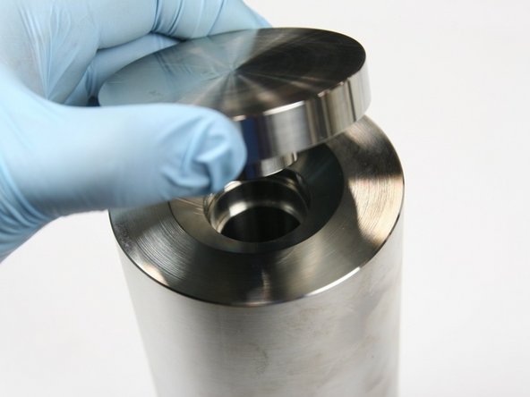

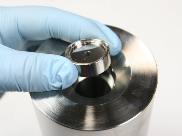

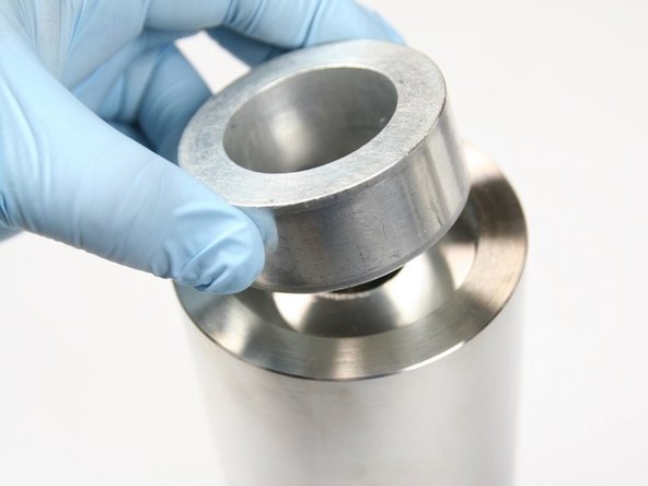

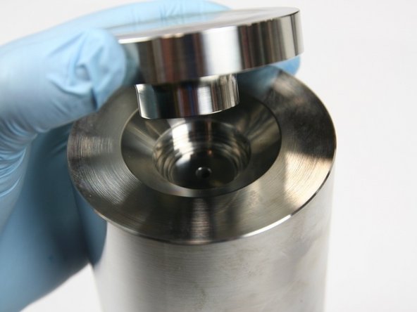

  2. Place HP cylinder on seal installation spacer tool, taper side down Apply light coat of high vacuum grease to both shoulders of spacer tube Insert spacer tube into cylinder with LP poppet end down
    • Place HP cylinder on seal installation spacer tool, taper side down
    • Apply light coat of high vacuum grease to both shoulders of spacer tube
    • Insert spacer tube into cylinder with LP poppet end down

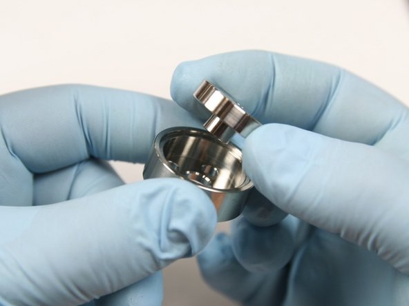

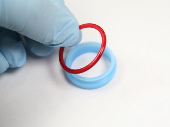

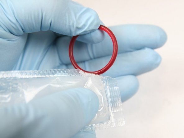

  3. Place locator tool on cylinder Place sleeve in locator tool with taper end up Apply light coat of high vacuum grease to red o-ring
    • Place locator tool on cylinder
    • Place sleeve in locator tool with taper end up
    • Apply light coat of high vacuum grease to red o-ring

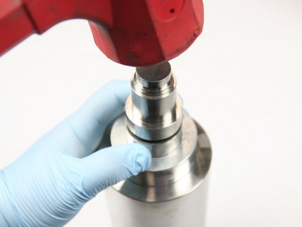

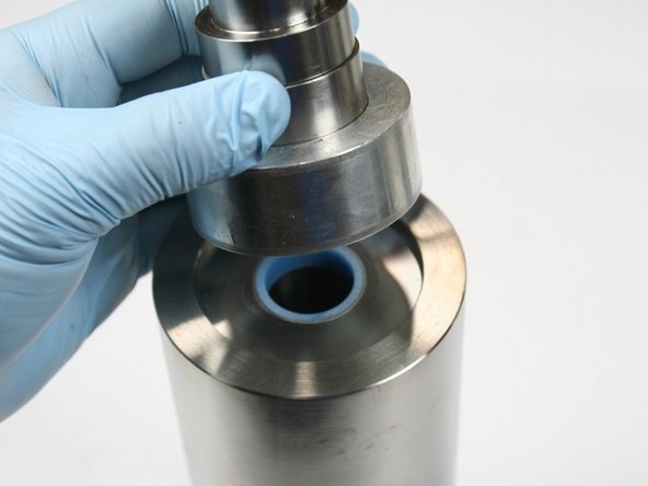

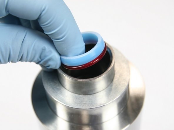

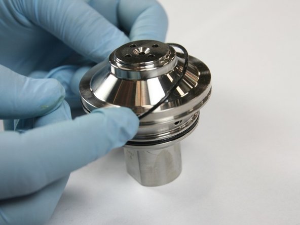

  4. Roll red o-ring into groove on HP seal Insert assembled HP seal into sleeve with red o-ring down towards cylinder Press HP seal into cylinder using non-stepped end of push tool
    • Roll red o-ring into groove on HP seal
    • Insert assembled HP seal into sleeve with red o-ring down towards cylinder
    • Press HP seal into cylinder using non-stepped end of push tool
    • Hold down sleeve while inserting HP seal to ensure seal doesn't catch on edge of HP cylinder

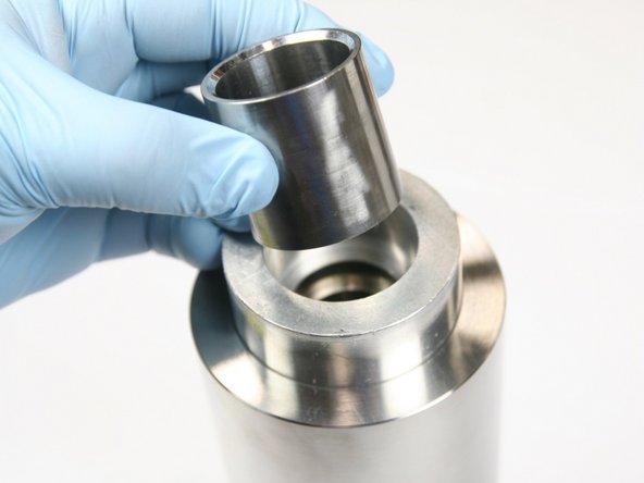

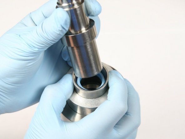

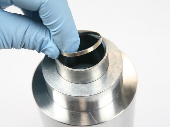

  5. Place hoop in sleeve with sharp edge of hoop down towards HP cylinder Seat hoop in HP cylinder using non-stepped end of push tool and dead blow hammer Hold down sleeve while seating hoop to ensure hoop doesn't catch on edge of HP cylinder
    • Place hoop in sleeve with sharp edge of hoop down towards HP cylinder
    • Seat hoop in HP cylinder using non-stepped end of push tool and dead blow hammer
    • Hold down sleeve while seating hoop to ensure hoop doesn't catch on edge of HP cylinder
    • Remove locator tool, sleeve, and push tool

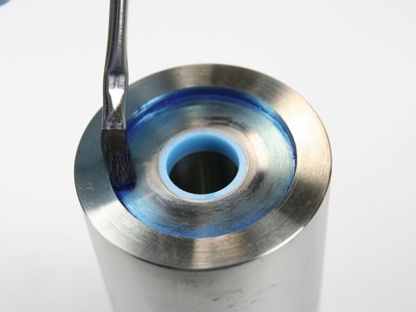

  6. Apply a light coat of blue goop to outer face of inset on end of HP cylinder Flip cylinder over and remove seal installation spacer tool Insert LP poppet in LP poppet basket so stem of poppet goes through center hole in basket
    • Apply a light coat of blue goop to outer face of inset on end of HP cylinder
    • Flip cylinder over and remove seal installation spacer tool
    • Insert LP poppet in LP poppet basket so stem of poppet goes through center hole in basket
    • Make sure LP poppet can freely move in LP poppet basket

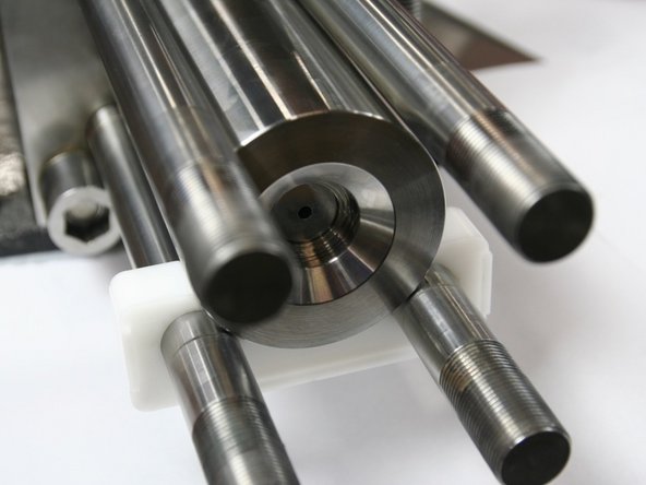

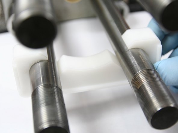

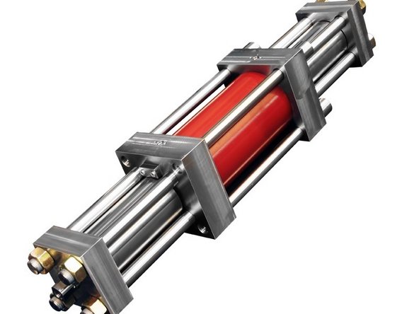

  7. Insert LP poppet and LP poppet basket into spacer tube in HP cylinder Place seal installation spacer tool on end of HP cylinder with step side down Place mounting cradle on bottom studs of intensifier with tabs toward outside of intensifier
    • Insert LP poppet and LP poppet basket into spacer tube in HP cylinder
    • Place seal installation spacer tool on end of HP cylinder with step side down
    • Place mounting cradle on bottom studs of intensifier with tabs toward outside of intensifier
  8. Push HP cylinder onto plunger using mounting cradle as a guide and seal installation spacer tool as a push tool Remove seal installation spacer tool, taking care to that LP poppet stays in LP poppet basket Apply light coat of o-ring lube to -035 and -031 o-rings for check valve
    • Push HP cylinder onto plunger using mounting cradle as a guide and seal installation spacer tool as a push tool
    • Remove seal installation spacer tool, taking care to that LP poppet stays in LP poppet basket
    • Apply light coat of o-ring lube to -035 and -031 o-rings for check valve

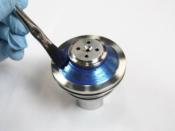

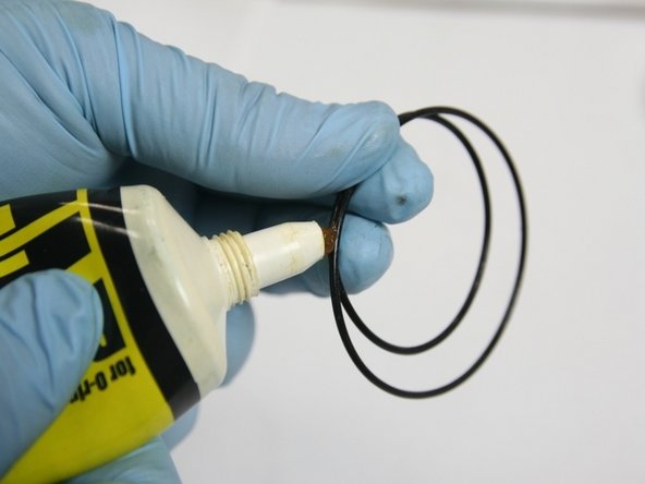

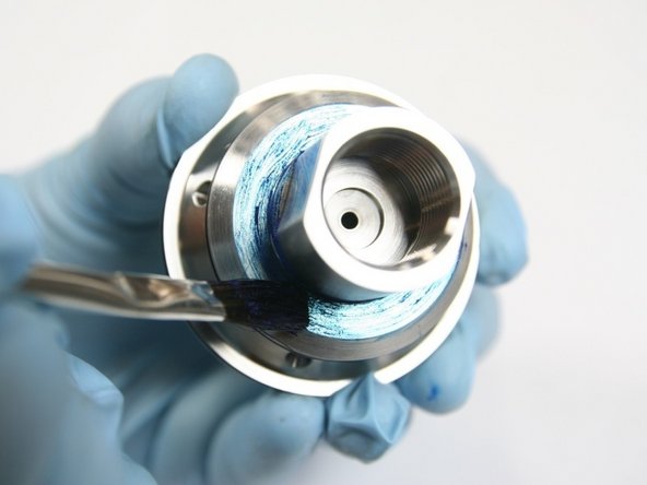

  9. Place -031 and -035 o-rings into grooves on check valve Apply light coat of blue goop to tapered (sealing) face of check valve Apply light coat of blue goop to bottom step of check valve
    • Place -031 and -035 o-rings into grooves on check valve
    • Apply light coat of blue goop to tapered (sealing) face of check valve
    • Apply light coat of blue goop to bottom step of check valve

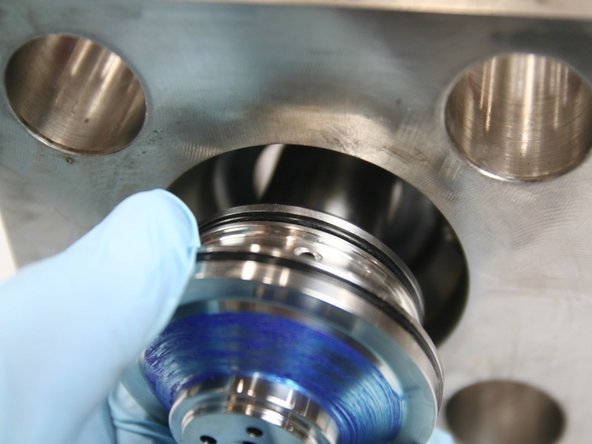

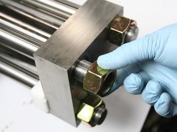

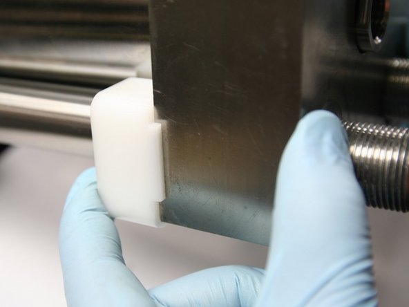

  10. Insert check valve into HP endcap Slide HP endcap with check valve onto intensifier studs Push HP endcap against HP cylinder and align tabs of mounting cradle so cradle supports HP endcap
    • Insert check valve into HP endcap
    • Slide HP endcap with check valve onto intensifier studs
    • Push HP endcap against HP cylinder and align tabs of mounting cradle so cradle supports HP endcap
    • The mounting cradle is used to ensure proper alignment between HP cylinder an HP endcap during torquing

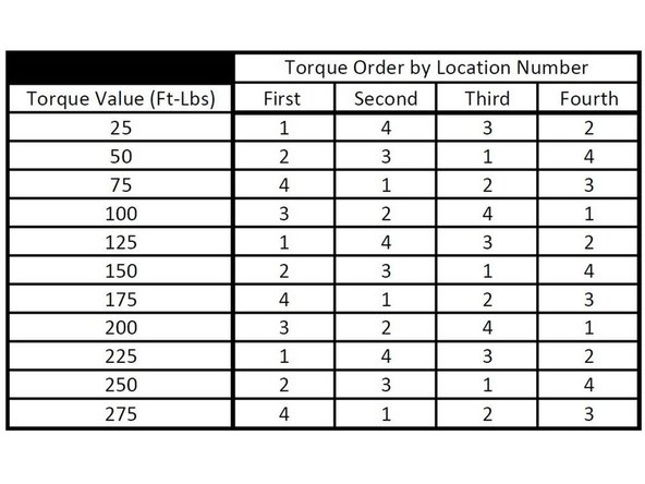

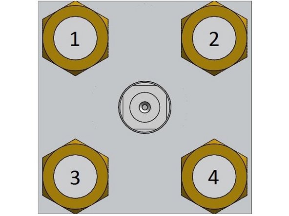

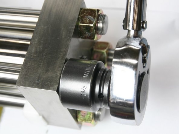

  11. Thread and hand-tighten nuts onto studs using a cross pattern Torque nuts using a cross pattern according to the following directions Use numbers in picture as a guide for location number found in included table for torquing procedure
    • Thread and hand-tighten nuts onto studs using a cross pattern
    • Torque nuts using a cross pattern according to the following directions
    • Use numbers in picture as a guide for location number found in included table for torquing procedure
  12. Torque each nut in torque order found in table to each torque value prior to stepping to next value Continue with HP poppet installation and standard start-up procedures
    • Torque each nut in torque order found in table to each torque value prior to stepping to next value
    • Continue with HP poppet installation and standard start-up procedures
