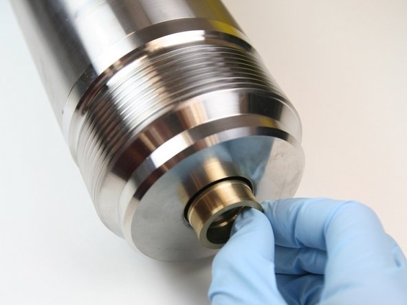

  2. Inspect the inside of the high-pressure cylinder. If scratches/galling have occurred, use Scotch Brite or similar abrasive pad to each end of the high-pressure cylinder to remove blemishes. Repeat the process (if needed) with 1500 grit abrasive to polish the inside of the bore. Apply high vacuum grease to the O-ring.
    • Inspect the inside of the high-pressure cylinder. If scratches/galling have occurred, use Scotch Brite or similar abrasive pad to each end of the high-pressure cylinder to remove blemishes.
    • Repeat the process (if needed) with 1500 grit abrasive to polish the inside of the bore.
    • Apply high vacuum grease to the O-ring.

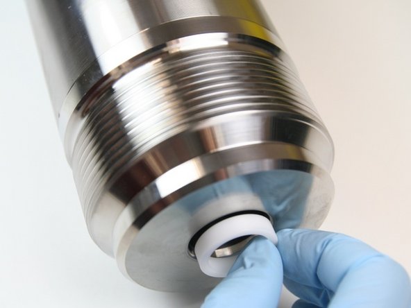

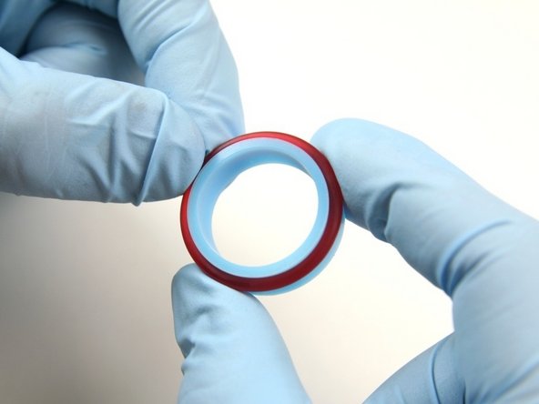

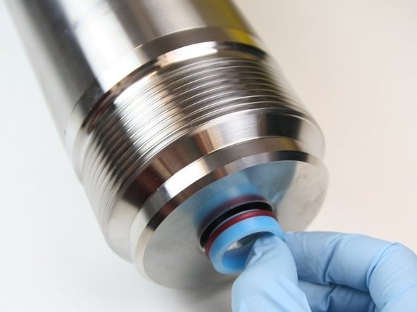

  3. Slide the O-ring onto the groove of the high-pressure seal. Put the high-pressure seal into the high-pressure cylinder. Put the dynamic seal back-up behind the high-pressure seal.
    • Slide the O-ring onto the groove of the high-pressure seal.
    • Put the high-pressure seal into the high-pressure cylinder.
    • Put the dynamic seal back-up behind the high-pressure seal.

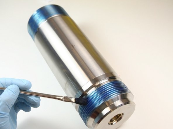

  4. Put the brass packing follower into the high-pressure cylinder, behind the dynamic seal back-up. Apply Blue Goop to the threads of the high-pressure cylinder.
    • Put the brass packing follower into the high-pressure cylinder, behind the dynamic seal back-up.
    • Apply Blue Goop to the threads of the high-pressure cylinder.
    • Reassemble the high-pressure cylinder into the intensifier assembly.
