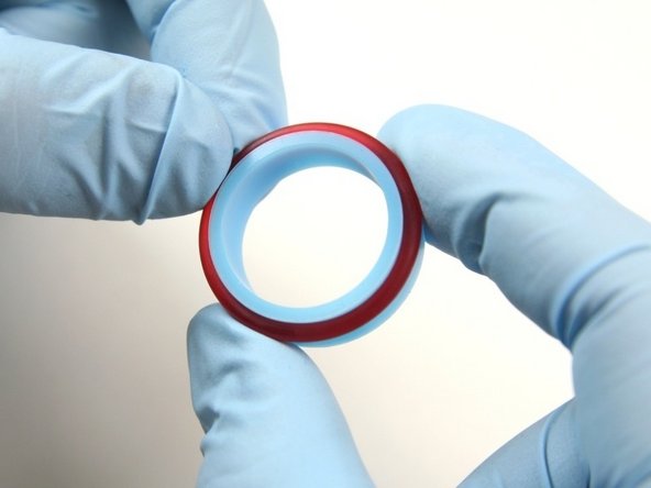

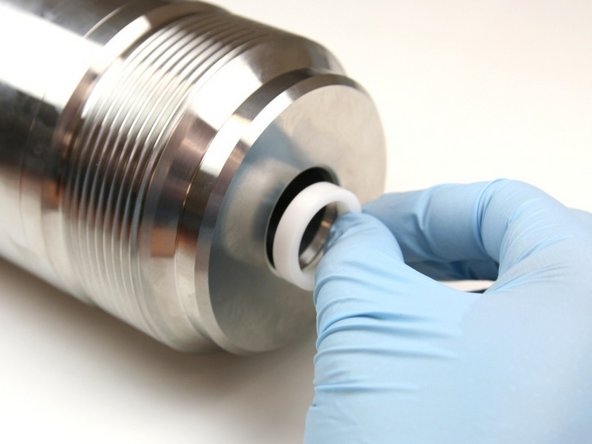

  3. Slide the O-ring onto the groove of the high-pressure seal. Put the high-pressure seal into the  dynamic end of the high-pressue cylinder. Put the dynamic seal back-up behind the high-pressure seal.
    • Slide the O-ring onto the groove of the high-pressure seal.
    • Put the high-pressure seal into the dynamic end of the high-pressue cylinder.
    • Put the dynamic seal back-up behind the high-pressure seal.

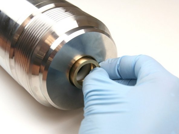

  4. Put the brass packing follower into the high-pressure cylinder, behind the  dynamic seal back-up.
    • Put the brass packing follower into the high-pressure cylinder, behind the dynamic seal back-up.
