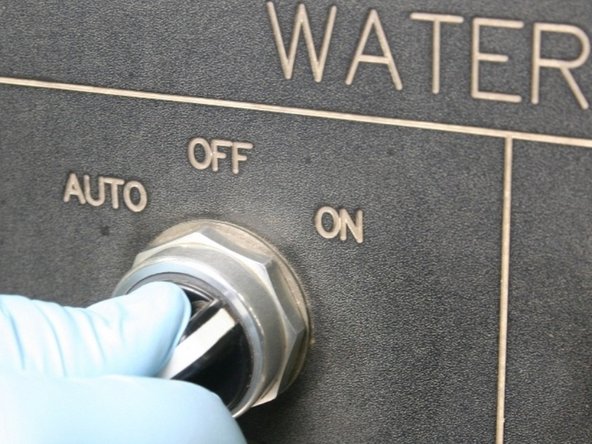

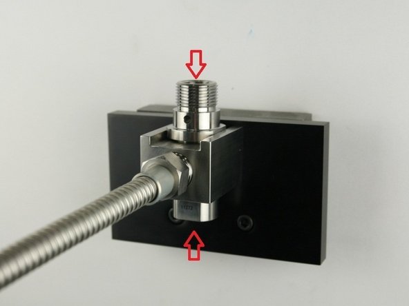

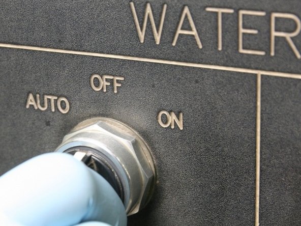

  1. Always make sure all high-pressure water has been removed from the valve by following the machine manufacturers' safety instructions. Failure to do so can cause severe injury or death. Turn OFF all water pressure to the on/off valve.
    • Always make sure all high-pressure water has been removed from the valve by following the machine manufacturers' safety instructions. Failure to do so can cause severe injury or death.
    • Turn the on/off valve ON to raise the poppet needle from poppet seat.

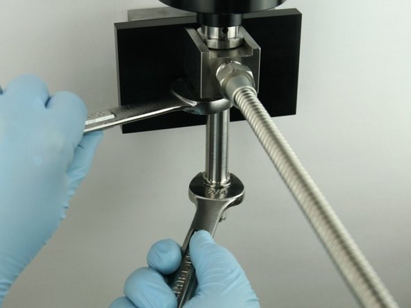

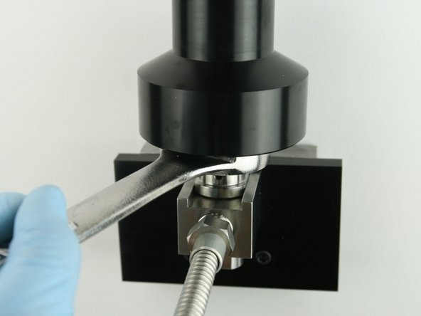

  2. The valve kit components can be replaced with the  valve body in the mounting collar. Unthread the nozzle tube from the valve body using a 3/4" and 7/8" wrench.
    • The valve kit components can be replaced with the valve body in the mounting collar.
    • Unthread the nozzle tube from the valve body using a 3/4" and 7/8" wrench.

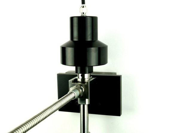

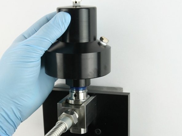

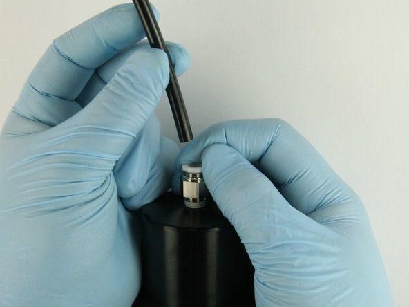

  3. Turn the air to the actuator OFF at the controls. Disconnect the air tube from the actuator. Unthread the actuator from the valve body using 1-1/8" wrench.
    • Turn the air to the actuator OFF at the controls.
    • Disconnect the air tube from the actuator.
    • Unthread the actuator from the valve body using 1-1/8" wrench.

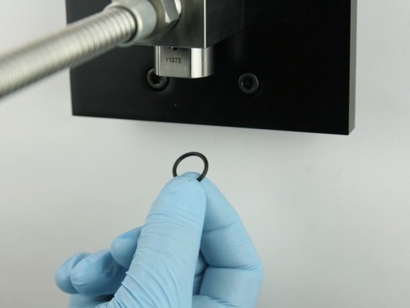

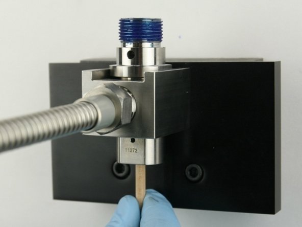

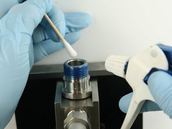

  4. Remove the old valve components from the valve body with the included dowel. Thoroughly clean the interior/exterior of the valve body with isopropyl alcohol or a similar cleaning agent before replacing the components. Visually inspect the top and bottom of the bore for cracks/blemishes.  If excessive wear or cracks are visible, replace the valve body.
    • Remove the old valve components from the valve body with the included dowel.
    • Thoroughly clean the interior/exterior of the valve body with isopropyl alcohol or a similar cleaning agent before replacing the components.
    • Visually inspect the top and bottom of the bore for cracks/blemishes. If excessive wear or cracks are visible, replace the valve body.

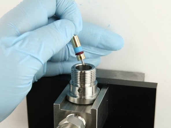

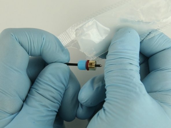

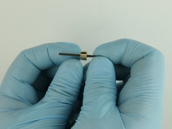

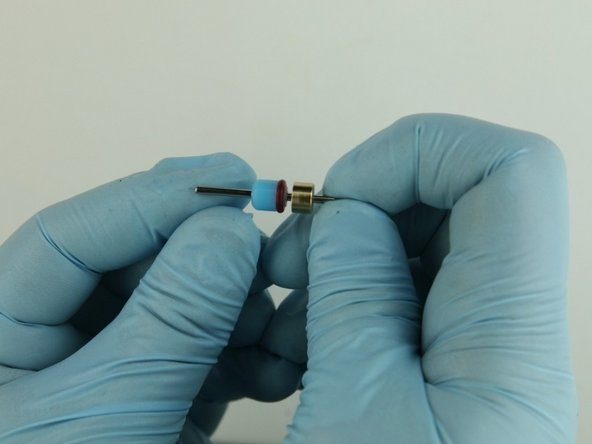

  5. Put the bushing stem onto the poppet stem. With the O-ring towards the bushing stem, slide the  high-pressure valve seal onto the poppet needle behind the bushing stem. Apply a high-pressure lubricant or similar (11136) to the  outside diameter of the high-pressure valve seal.
    • Put the bushing stem onto the poppet stem.
    • With the O-ring towards the bushing stem, slide the high-pressure valve seal onto the poppet needle behind the bushing stem.
    • Apply a high-pressure lubricant or similar (11136) to the outside diameter of the high-pressure valve seal.

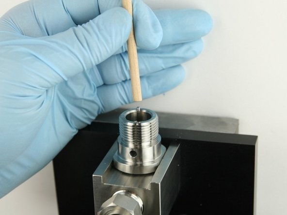

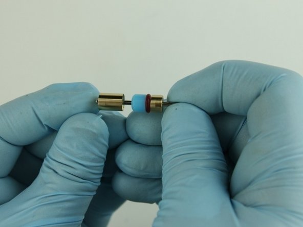

  6. Put the back-up ring with the concave side towards the seal then slide on the poppet needle behind the high-pressure seal. Put the poppet needle, with the point down, at the top of the valve body. Use the dowel to push the poppet needle down until the back-up ring is flush with the top of the bore.
    • Put the back-up ring with the concave side towards the seal then slide on the poppet needle behind the high-pressure seal.
    • Put the poppet needle, with the point down, at the top of the valve body.
    • Use the dowel to push the poppet needle down until the back-up ring is flush with the top of the bore.

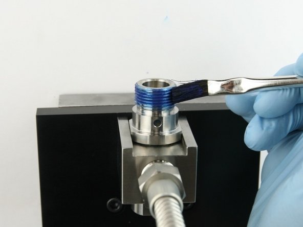

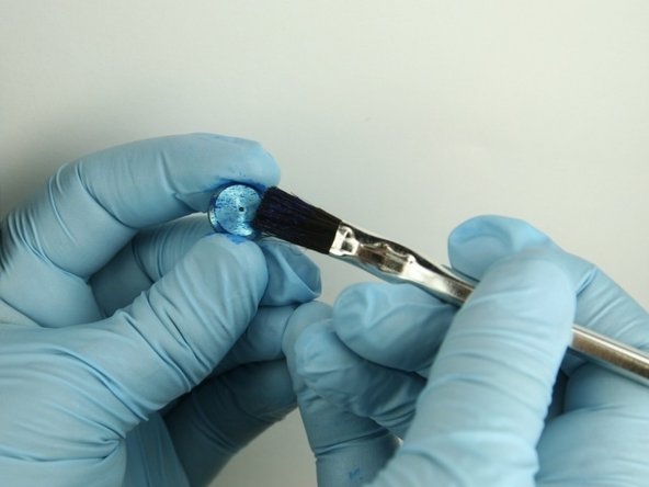

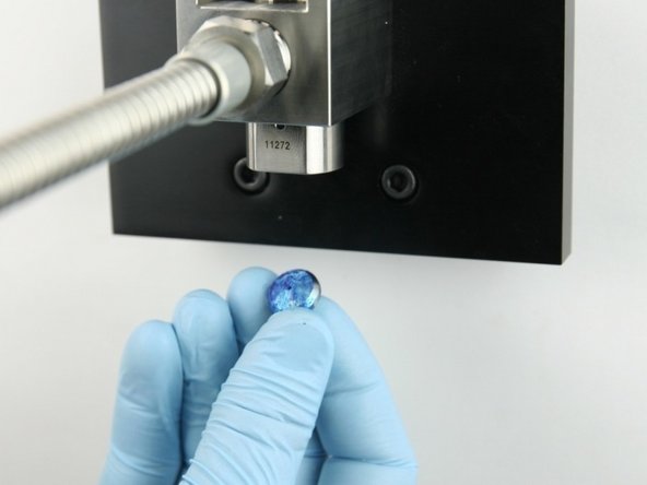

  7. Apply Blue Goop to all surfaces of the poppet seat. Put the poppet seat at the bottom of the valve body. Put the  O-ring behind the poppet seat so it is held in place.
    • Apply Blue Goop to all surfaces of the poppet seat.
    • Put the poppet seat at the bottom of the valve body.
    • Put the O-ring behind the poppet seat so it is held in place.

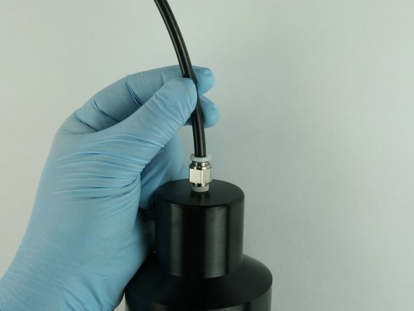

  8. Apply Blue Goop to the top threads of the valve body. Thread (hand tighten) the actuator onto the top of the valve body. Reconnect the air line to the top of the actuator.
    • Apply Blue Goop to the top threads of the valve body.
    • Thread (hand tighten) the actuator onto the top of the valve body.
    • Reconnect the air line to the top of the actuator.

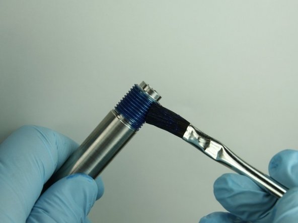

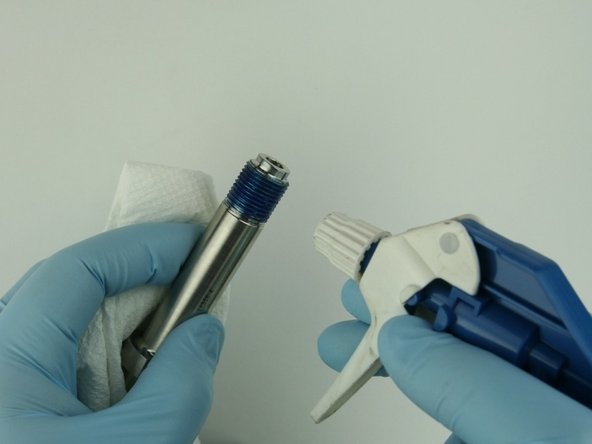

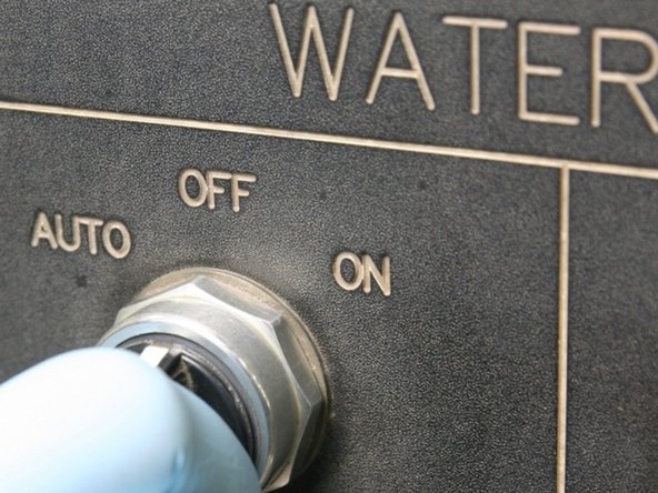

  9. Turn the actuator air pressure ON to relieve the pressure from the poppet needle. Thoroughly clean the nozzle tube of all Blue Goop. Reapply Blue Goop to the threads of the nozzle tube.
    • Turn the actuator air pressure ON to relieve the pressure from the poppet needle.
    • Thoroughly clean the nozzle tube of all Blue Goop.
    • Reapply Blue Goop to the threads of the nozzle tube.
  10. Thread the nozzle tube into the bottom of the valve body. Tighten the nozzle tube to the valve using a 3/4" and 7/8" wrench. Turn the air to the actuator OFF to set the poppet needle into the poppet seat.
    • Thread the nozzle tube into the bottom of the valve body.
    • Tighten the nozzle tube to the valve using a 3/4" and 7/8" wrench.
