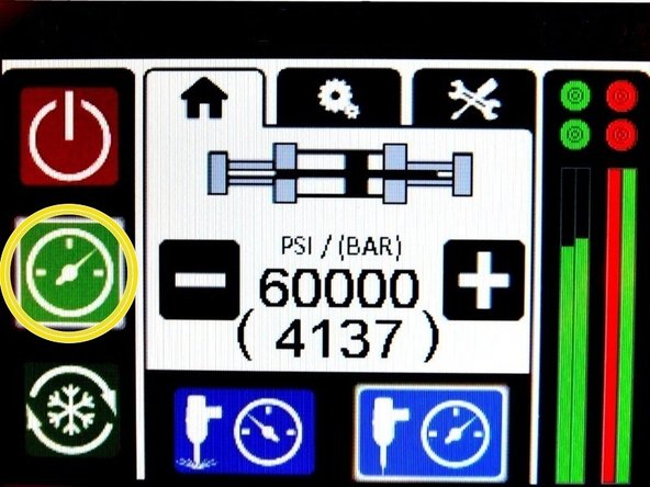

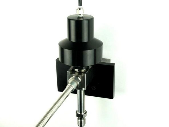

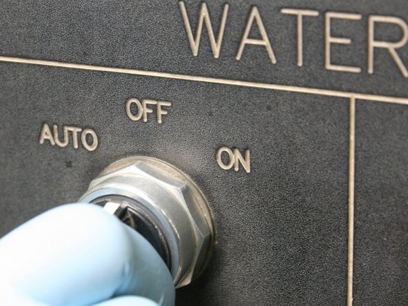

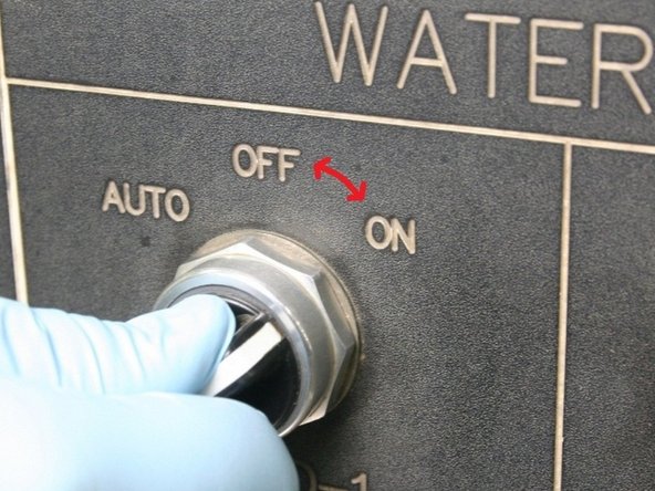

  1. Always make sure all high-pressure water has been removed from the valve by following the machine manufacturers' safety instructions. Failure to do so can cause severe injury or death. Turn OFF all water pressure to the on/off valve.
    • Always make sure all high-pressure water has been removed from the valve by following the machine manufacturers' safety instructions. Failure to do so can cause severe injury or death.
    • Turn the on/off valve ON to raise the poppet stem from the high-pressure seat.
  2. The valve kit components can be replaced with the   valve body in the mounting collar. Loosen the nozzle tube from the valve body using a 3/4" and 7/8" wrench. Unthread the nozzle tube from the valve body.
    • The valve kit components can be replaced with the valve body in the mounting collar.
    • Loosen the nozzle tube from the valve body using a 3/4" and 7/8" wrench.
    • Unthread the nozzle tube from the valve body.

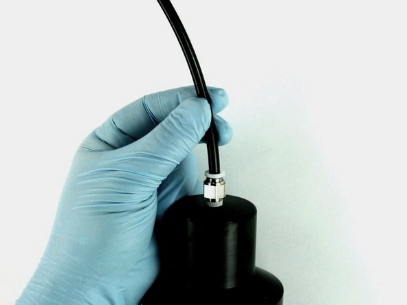

  3. Turn the air to the actuator OFF at the controls. Disconnect the air line from the actuator. Unthread the actuator from the valve body using a 1-1/8" wrench.
    • Turn the air to the actuator OFF at the controls.
    • Disconnect the air line from the actuator.

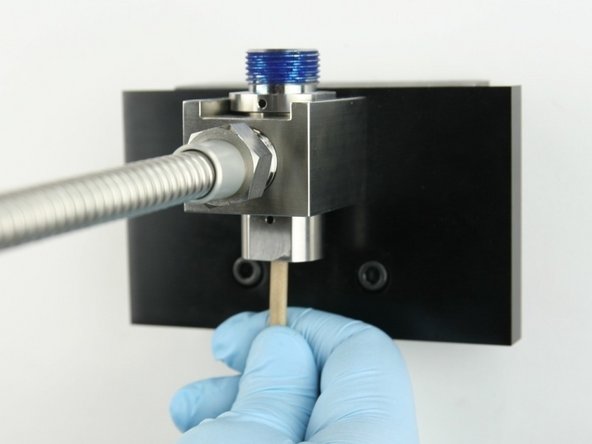

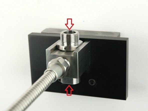

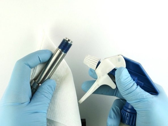

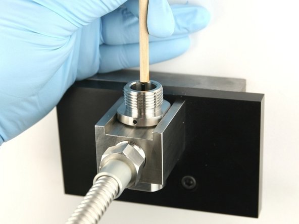

  4. Remove the old valve components from the valve body with the included dowel. Thoroughly clean the interior/exterior of the valve body with isopropyl alcohol or similar cleaning agent before replacing the components. Visually inspect the top and bottom of the bore for cracks/blemishes. If excessive wear or cracks are visible, replace the valve body.
    • Remove the old valve components from the valve body with the included dowel.
    • Thoroughly clean the interior/exterior of the valve body with isopropyl alcohol or similar cleaning agent before replacing the components.
    • Visually inspect the top and bottom of the bore for cracks/blemishes. If excessive wear or cracks are visible, replace the valve body.

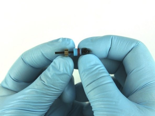

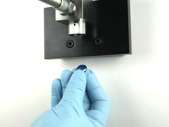

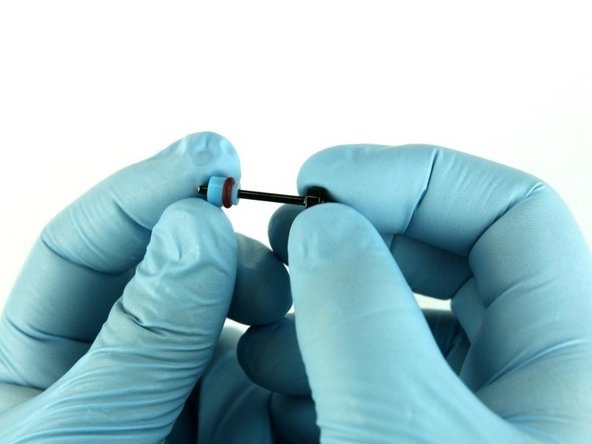

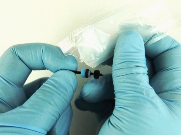

  5. With the O-ring towards the point of the poppet stem, slide the high-pressure valve seal on to the poppet stem. Apply a high-pressure lubricant or similar (11336) to the outside diameter of the high-pressure valve seal. Slide the  back-up ring on to the poppet stem behind the high-pressure valve seal.
    • With the O-ring towards the point of the poppet stem, slide the high-pressure valve seal on to the poppet stem.
    • Apply a high-pressure lubricant or similar (11336) to the outside diameter of the high-pressure valve seal.
    • Slide the back-up ring on to the poppet stem behind the high-pressure valve seal.

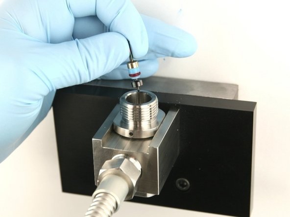

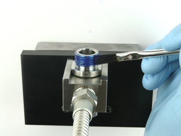

  6. Put the poppet stem, with the point down, at the top of the valve body. Use the dowel to push the poppet stem down until the back-up ring is flush with the top of the bore. Apply Blue Goop to the  top threads of the valve body.
    • Put the poppet stem, with the point down, at the top of the valve body.
    • Use the dowel to push the poppet stem down until the back-up ring is flush with the top of the bore.
    • Apply Blue Goop to the top threads of the valve body.

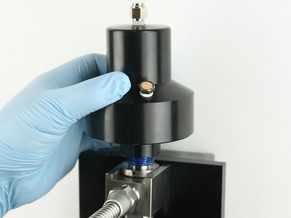

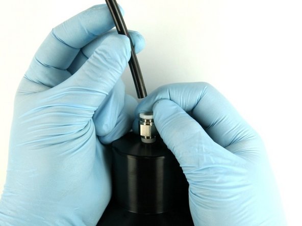

  7. Thread (hand tighten) the actuator to the top of the valve body. Reconnect the air line to the top of the actuator. Turn the air to the actuator ON to relieve the pressure from the poppet stem.
    • Thread (hand tighten) the actuator to the top of the valve body.
    • Reconnect the air line to the top of the actuator.
    • Turn the air to the actuator ON to relieve the pressure from the poppet stem.

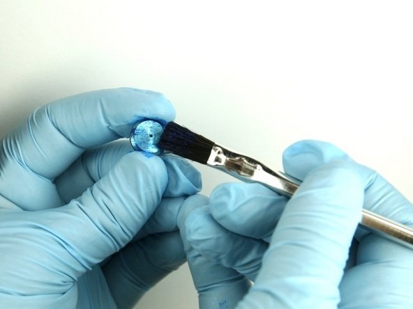

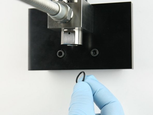

  8. Apply Blue Goop to all surfaces of the high-pressure seat. Put the high-pressure seat at the  bottom of the valve body. Put the O-ring behind the high-pressure seat so it will be held in place within the valve body.
    • Apply Blue Goop to all surfaces of the high-pressure seat.
    • Put the high-pressure seat at the bottom of the valve body.
    • Put the O-ring behind the high-pressure seat so it will be held in place within the valve body.

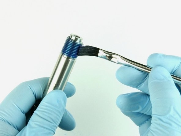

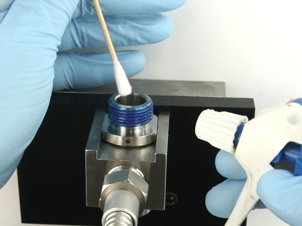

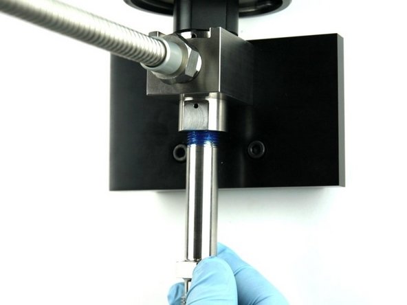

  9. Thoroughly clean the nozzle tube of all the Blue Goop. Reapply Blue Goop to the threads of the nozzle tube. Thread the nozzle tube into the bottom of the valve body.
    • Thoroughly clean the nozzle tube of all the Blue Goop.
    • Reapply Blue Goop to the threads of the nozzle tube.
    • Thread the nozzle tube into the bottom of the valve body.

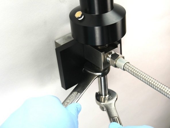

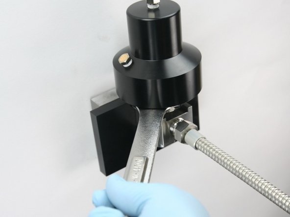

  10. Tighten the nozzle tube to the valve body using a 3/4" and 7/8" wrench. Turn the air to the actuator OFF to set the poppet stem into the high-pressure seat. Apply water pressure to the valve assembly to verify there are no leaks.
    • Tighten the nozzle tube to the valve body using a 3/4" and 7/8" wrench.

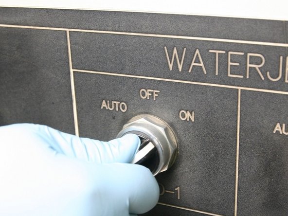

    • Turn the air to the actuator OFF to set the poppet stem into the high-pressure seat.
    • Apply water pressure to the valve assembly to verify there are no leaks.
