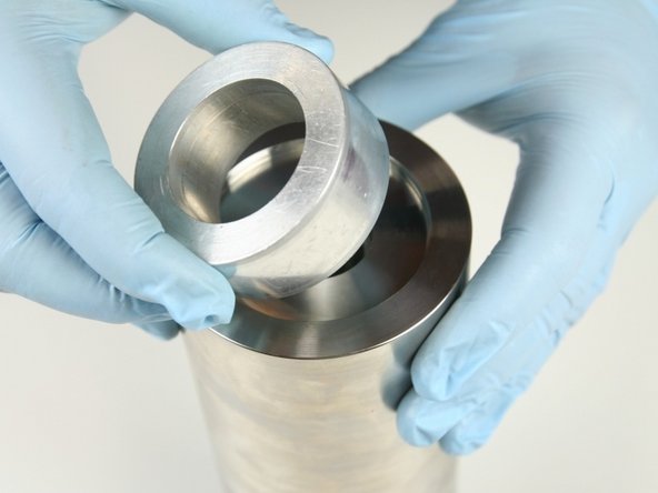

Image 1/3: Remove the check valve from the [http://www.accustream.com/all-products/11522.html|high-pressure cylinder] Image 2/3: Remove the [http://www.accustream.com/waterjet-parts/accustream/pump-parts/11526.html|low-pressure poppet] from the high-pressure cylinder. Image 3/3: Remove the [http://www.accustream.com/waterjet-parts/accustream/pump-parts/11526.html|low-pressure poppet] from the high-pressure cylinder.

  • Put the high-pressure cylinder onto the locator tool.
  • Put the stepped end of the push tool into the top of the high-pressure cylinder.
  • Hit the push tool with a rubber mallet to push out the high-pressure seal and hoop

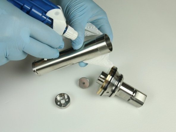

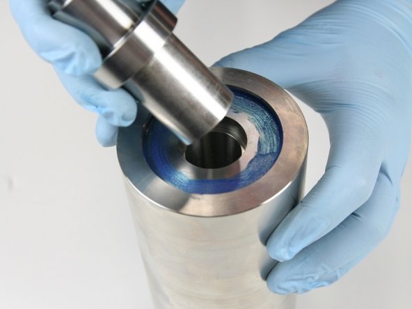

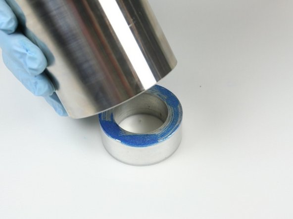

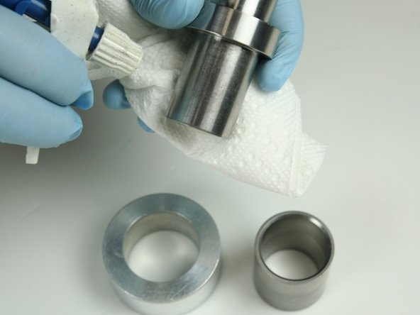

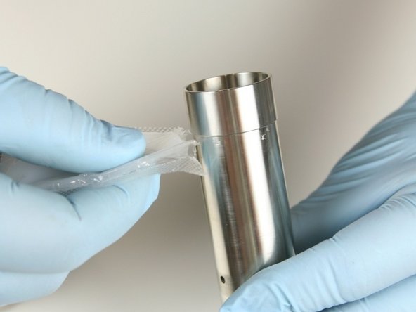

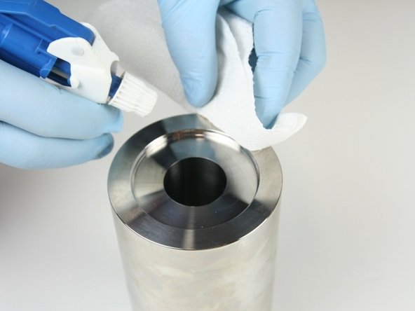

Image 1/3: Clean the removal/installation tools with isopropyl alcohol or a similar cleaning agent. Image 2/3: Clean the spacer tube, check valve,  low-pressure poppet, and low-pressure poppet basket. Image 3/3: Clean the spacer tube, check valve,  low-pressure poppet, and low-pressure poppet basket.
  • Clean the high-pressure cylinder of all Blue Goop with isopropyl alcohol or a similar cleaning agent.
  • Clean the removal/installation tools with isopropyl alcohol or a similar cleaning agent.
  • Clean the spacer tube, check valve, low-pressure poppet, and low-pressure poppet basket.

Image 1/3: Clean the high-pressure cylinder once more to remove all excess material from Scotch Brite Image 2/3: Put the high-pressure cylinder onto the high-pressure seal installation spacer tool. Image 3/3: Put the high-pressure cylinder onto the high-pressure seal installation spacer tool.
  • Roll scouring pad in both ends of the bore of the high-pressure cylinder to remove any blemishes.
  • Clean the high-pressure cylinder once more to remove all excess material from Scotch Brite

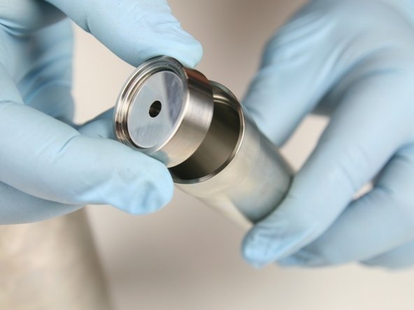

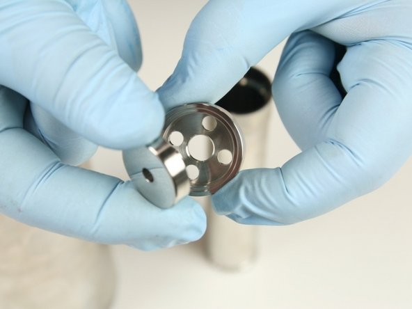

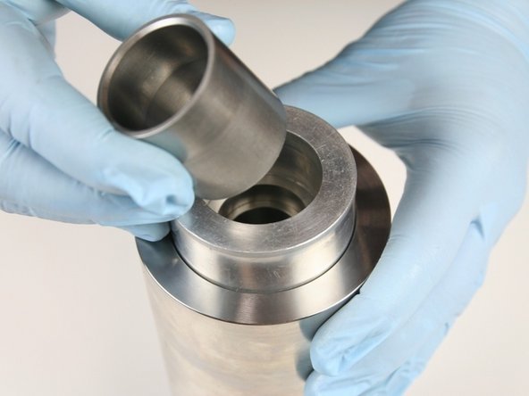

Image 1/3: Put the low-pressure poppet into the low-pressure poppet basket with the stem of the poppet facing basket. Image 2/3: Make sure that the low-pressure poppet moves freely in the low-pressure poppet basket. Image 3/3: Make sure that the low-pressure poppet moves freely in the low-pressure poppet basket.
  • Apply a light coat of high vacuum grease to both ends of the spacer tube.
  • Put the low-pressure poppet into the low-pressure poppet basket with the stem of the poppet facing basket.
  • Make sure that the low-pressure poppet moves freely in the low-pressure poppet basket.
Add Comment

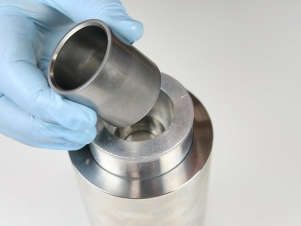

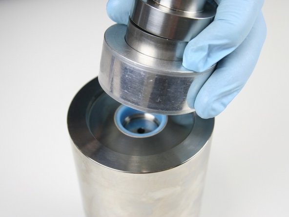

Image 1/3: Put the spacer tube with the poppet and basket up into the high-pressure cylinder. Image 2/3: Put the locator tool onto the high-pressure cylinder. Image 3/3: Put the locator tool onto the high-pressure cylinder.
  • Put the low-pressure poppet and basket into the spacer tube.
  • Put the spacer tube with the poppet and basket up into the high-pressure cylinder.
  • Put the locator tool onto the high-pressure cylinder.

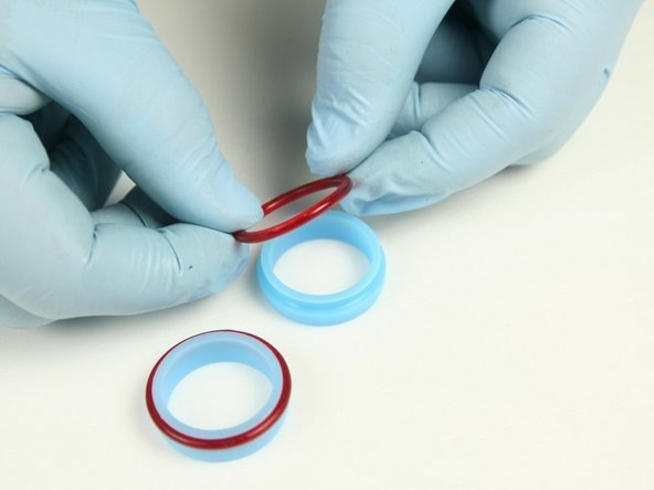

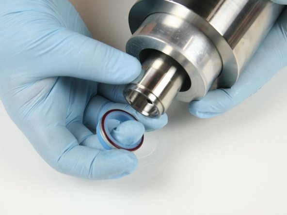

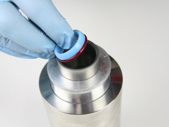

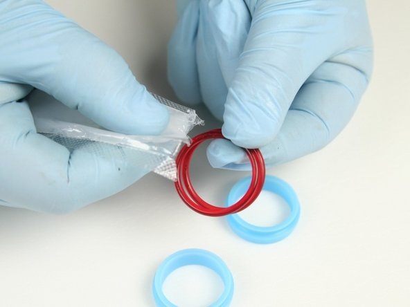

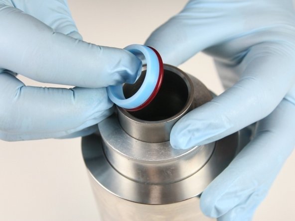

Image 1/3: Apply high vacuum grease to the O-rings. Image 2/3: Put the O-rings onto the high-pressure seals. Image 3/3: Put the O-rings onto the high-pressure seals.
  • Put the sleeve into the locator tool with the tapered end up.
  • Apply high vacuum grease to the O-rings.
  • Put the O-rings onto the high-pressure seals.

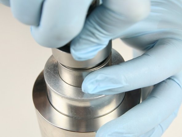

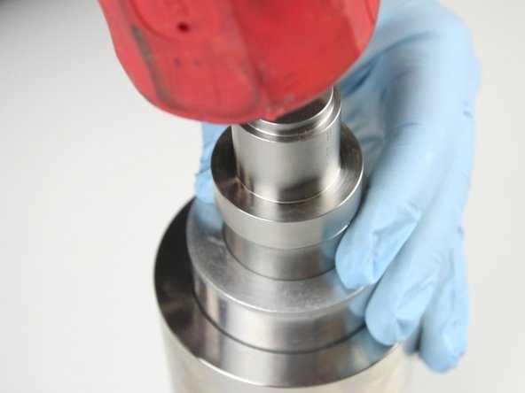

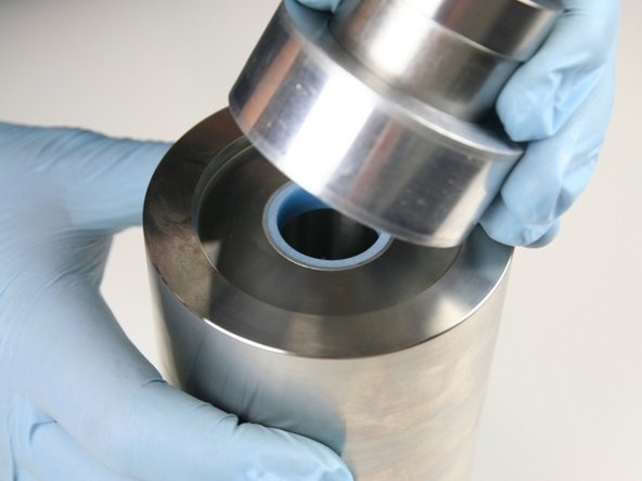

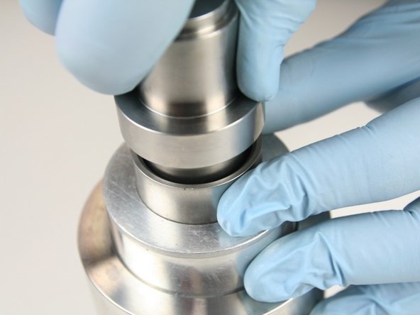

Image 1/3: Put the non-stepped end of the push tool into the sleeve and press the high-pressure seal into the high-pressure cylinder until it bottoms out. Image 2/3: Hold the sleeve down against the cylinder with one hand to be sure it doesn't raise up while installing the seal. Image 3/3: Put the hoop into the sleeve with the tapered end down towards the high-pressure seal.
  • Put the high-pressure seal into the sleeve with the O-ring down.
  • Put the non-stepped end of the push tool into the sleeve and press the high-pressure seal into the high-pressure cylinder until it bottoms out.
    • Hold the sleeve down against the cylinder with one hand to be sure it doesn't raise up while installing the seal.
  • Put the hoop into the sleeve with the tapered end down towards the high-pressure seal.

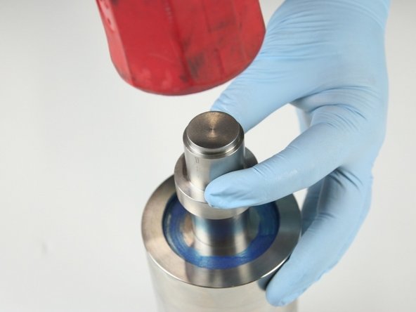

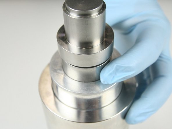

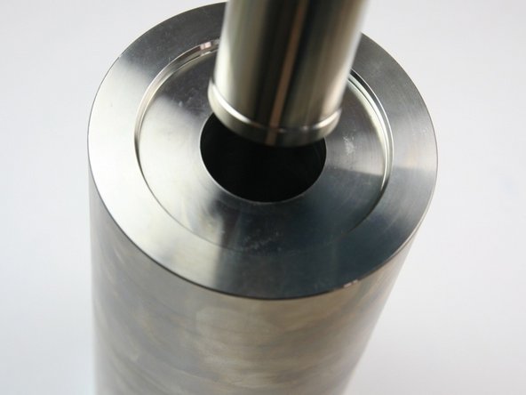

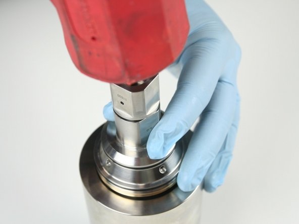

Image 1/3: Use a rubber mallet to set the hoop into the high-pressure cylinder (until the push tool bottoms out). Image 2/3: Hold the sleeve down against the cylinder with one hand to be sure it doesn't raise up while installing the hoop. Image 3/3: Remove the installation tools from the top of the high-pressure cylinder.
  • Put the non-stepped end of the push tool into the sleeve and be sure that the tool is level with the sleeve.
  • Use a rubber mallet to set the hoop into the high-pressure cylinder (until the push tool bottoms out).
    • Hold the sleeve down against the cylinder with one hand to be sure it doesn't raise up while installing the hoop.
  • Remove the installation tools from the top of the high-pressure cylinder.

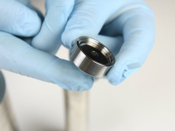

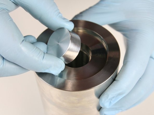

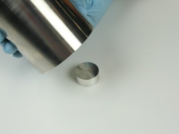

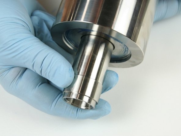

Image 1/3: Use a rubber mallet to tap the check valve into the high-pressure cylinder. Image 2/3: Flip the high-pressure cylinder over so the cylinder is resting on the check valve. Image 3/3: Flip the high-pressure cylinder over so the cylinder is resting on the check valve.
  • Put the check valve on the high-pressure cylinder.
  • Use a rubber mallet to tap the check valve into the high-pressure cylinder.
  • Flip the high-pressure cylinder over so the cylinder is resting on the check valve.

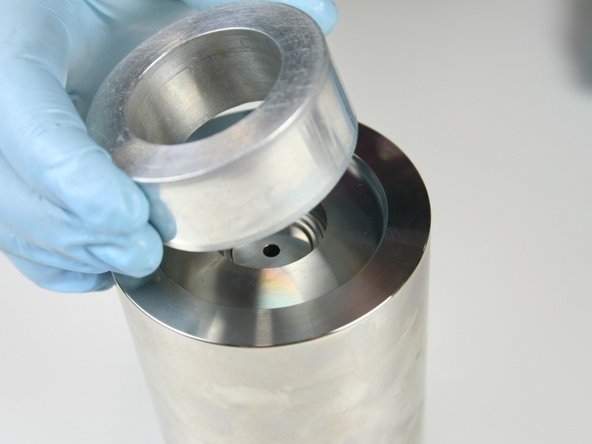

Image 1/3: Put the locator tool on the high-pressure cylinder. Image 2/3: Put the sleeve into the locator tool with the tapered end up. Image 3/3: Put the sleeve into the locator tool with the tapered end up.
  • Remove the seal installation spacer tool from the end of the high-pressure cylinder.
  • Put the locator tool on the high-pressure cylinder.

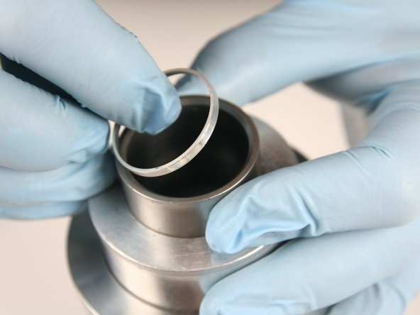

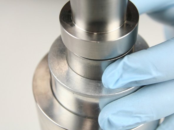

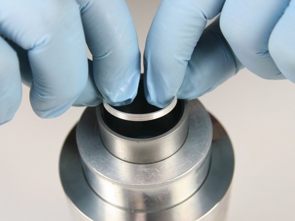

  • Put the high-pressure seal into the sleeve with the o-ring down.

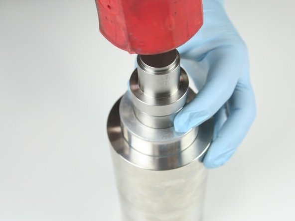

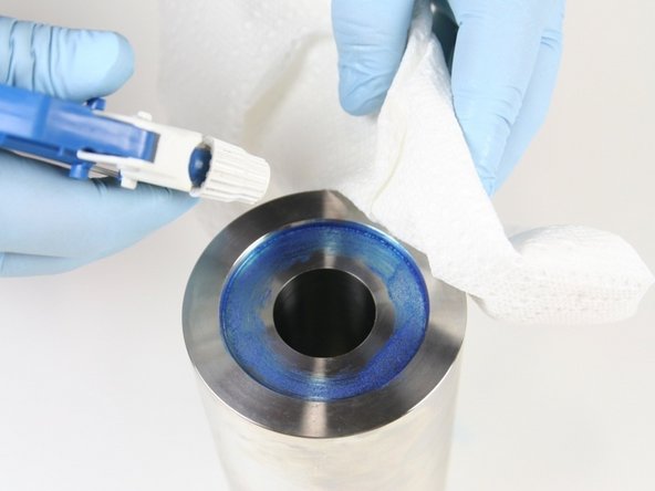

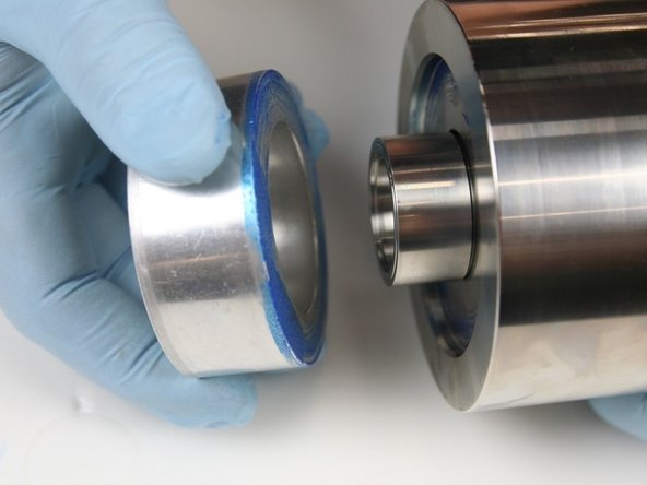

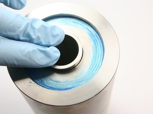

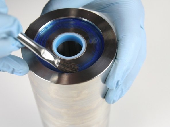

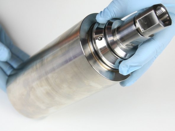

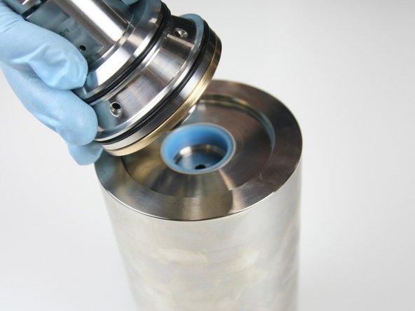

Image 1/2: Continue with the installation with the high-pressure cylinder onto the intensifier. Image 2/2: Continue with the installation with the high-pressure cylinder onto the intensifier.
  • Apply Blue Goop to the outer edge of the high-pressure cylinder inset.
  • Continue with the installation with the high-pressure cylinder onto the intensifier.
